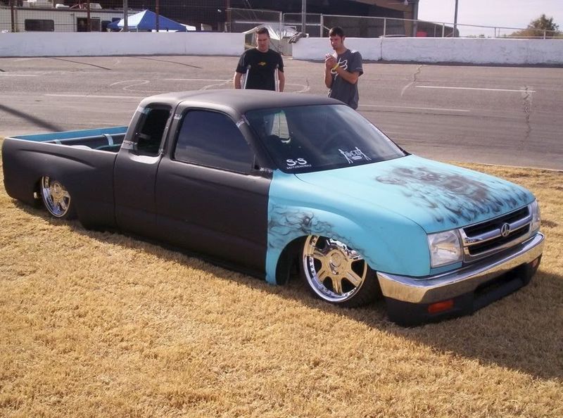

Truck looks soooooooo good chopped, we can't wait to shoot the final product

What is involved in doing a chop that way? Looks like he chopped "X" amount of the A and B pilliars. Am I right? Inform me!

This is now my new dream truck. Props to the guy and the fabricators. I need to get all the details on this thing. How much did he chop it cause it came our PERFECT...did he use stock glass again? I just can't leave this thread alone.

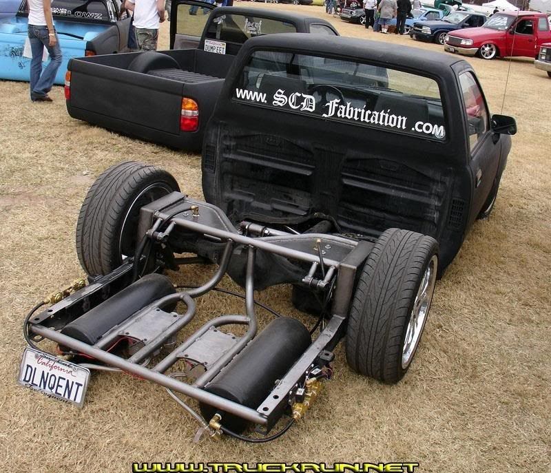

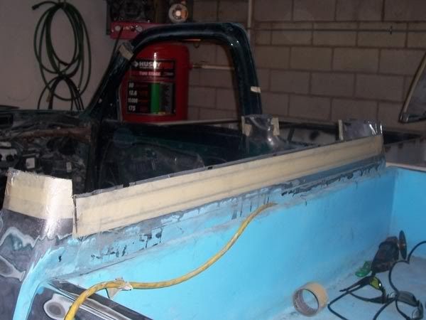

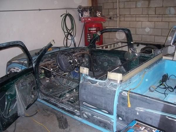

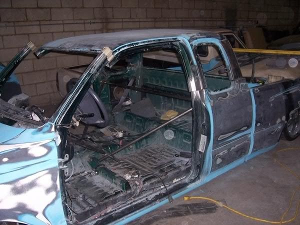

well ill do my best to answer questions.. if you want to talk to the guys who actually did the work go to SCDFabrication.comthe chop is about 3 inchs.... the truck was cut along the bottom of the back window so the stock back glass is still used, makes the back window look sick as hell. pillars were cut and leaned back and the side windows cut and angled out. front side windows are very close you fitting and most likely can be sanded down to fit nicely with some time. heres some mroe pics for you all..... this truck is truely one of the sickest tacos and when its done its gonna dominate.
IN THIS PIC IS ANOTHER TRUCK DONE BY SCDBUT YOU CAN SEE THE BACK OF JOELS TRUCK COMPARED TO ANOTHER SCD TACO, LOOK AT THE BACK WINDOWS.... WAY SICK.
