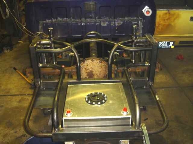

draggindimes's avatar
draggindimes
i just finished backhalfing my truck. i used 2x4 x .120 box tubing and flatstock. but if you wanna do a stack floor use 3x3 x .120 or 2x3 x .120...heres some pics
