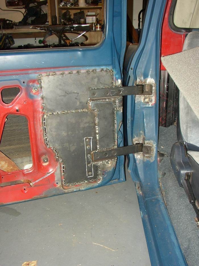

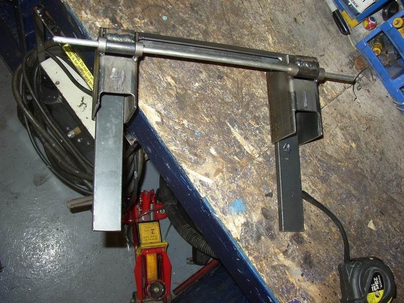

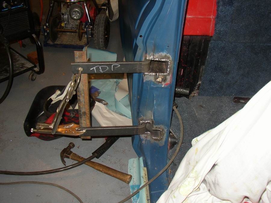

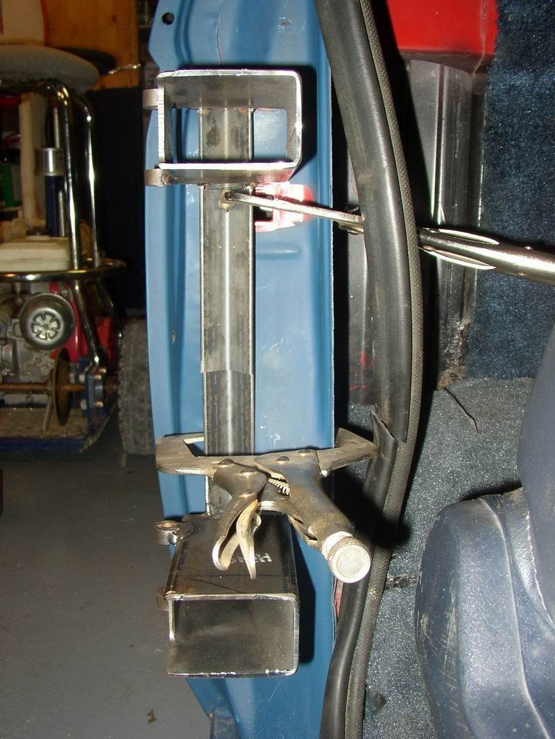

Heres my homemade hinges.. they work good open full 90 degrees
heres some brief pics of the install
in the one pic where the paints removed the hinge pockets had fallen out thats why they they look wierd

damn dude, good job on making your own.. thats badass. looks great

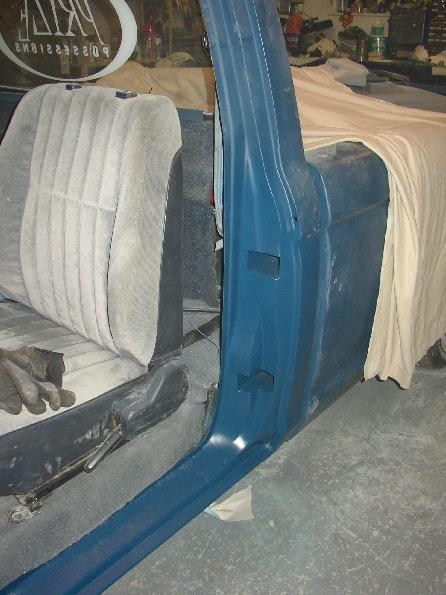

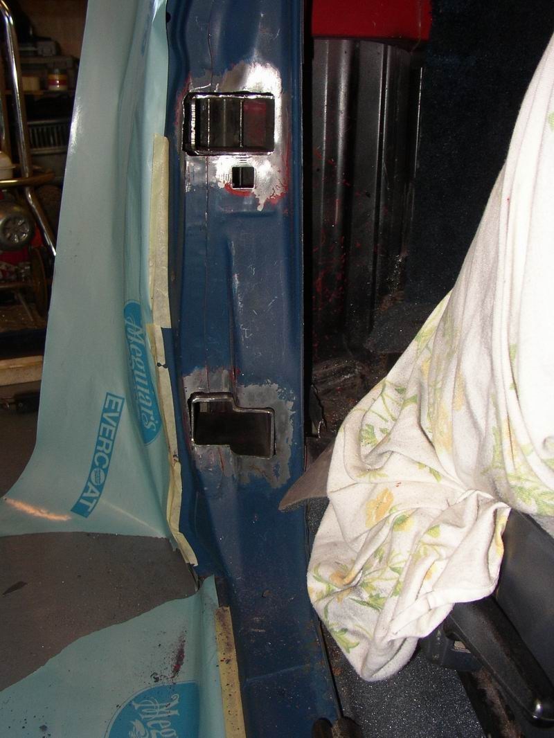

heres the pockets all bodyworked n such if you wanted to see
