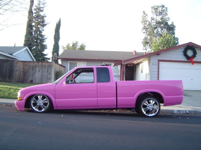

how do u people that get alot of lift in the back keep the driveshaft from pulling out of the tranny??

i get a pretty good amount of lift and the only problem i have is a little vibration when i'm totally locked up in the rear. this pic is about as high as i can ride without vibration

i would say it doesnt go any higer then that---->
