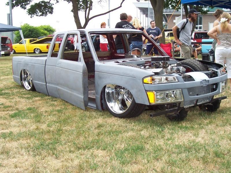

hey all, i have already started my suicide doors on my 91 sonoma. I am using the SD.com kit. Now my question is, other than the instructions jason sends, is their any other hints/tips you could give from any past experiences. They just seem like they are gonna wanna sag, and not line up properly, thankscory

If this is your truck are you redoing the doors?
