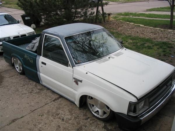

hey are any of you guys running escalade wheels with a bodydrop to the rockers with 2wd bed and fenders. i know the front will rub with drop spindles, but i corrected that problem, but for the rear it seems to be rubbing the bed, like by a good amount. is that normal with you guys too!? its a 2600i by teh way 2wd, i dont knwo if those have a different rear end. and one other thingk, does anyone how much it cost to shorten a mazda rear end, and where i could get it done in teh northeast? thanks alot

The bed supports you cut and extended from the floor to the bedside, cut them again, have someone pull the fender out slightly, and weld them back together.
Easy as pie.

yeah russ thats what i think it was, cuz when i finished the bed i didnt have it on the cab or anything and i bodydropped that first. Actually Big Joe, i bodydropped the bed last winter, and joe colon came down and helped me out . thanks russ
