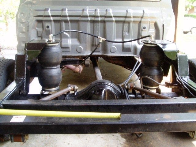

bagmazdog
u gotta look real hard but u can somewhat c in 1 of my pics. basicaly all ur going to do is undo the line that goes in from the front, undo the line that comes from ur diff and connect them with the brake hose. dont worry about all the lines on the unit, ignore them. ur bypassing all that. the brake set up on a mazdawg is the bake fluid comes bake feeds though the hose and line into the top port of the wheel cylinder on the pass side, comes out the bottom port and feeds all the way across the the wheel cylinder on the driver side. just picure how simple it is with that unit not in there and u will c exacly how to do it.
bagmazdog
bagmazdog
OOO i forgot to tell ya if ur doing a notch all u have to do is replace the last piece of metal line that would have fed into that unit with a longer 1 and bend it to shape with the notch. i think cant remember but i think it about a 54" piece if that. cost u about 10-15 $$$$ from autozone. just take a piece of line with the size fitting u need and match it up so u wont have to make more than 1 trip.!!!! look closely at the pic and follow the hose to both ends and u can c how its done.
