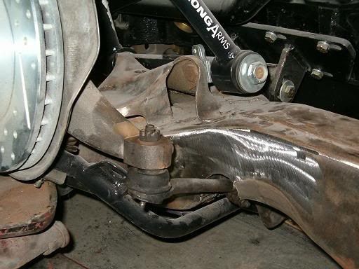

heres a pic on how i did my tierods to lay on 20s. hope it helps
http://i12.photobucket.com/albums/a232/lowpuppy69/pic16.jpg
