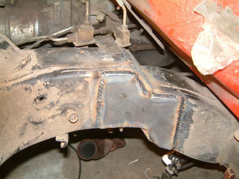

rockeredranger
thanks cris that pic was really helpful... did you shift the frame forward at all there? just aking cause it looks like you did the way that line bolts up... anyways, so if i cut and and just raise it straight up that should be good, right? this is my first time trying this, and i dont wanna mess my truck up too much haha. thanks alot.
bdroppeddak's avatar
bdroppeddak
if you dont have an angle finder, get one, that way you can level the truck out on stands, and make note of the angle that the front clip is, and i raised it straight up, that way when i dropped the frame horns the same, bolted up the core support, the hood shut like it came zed from the factory.
