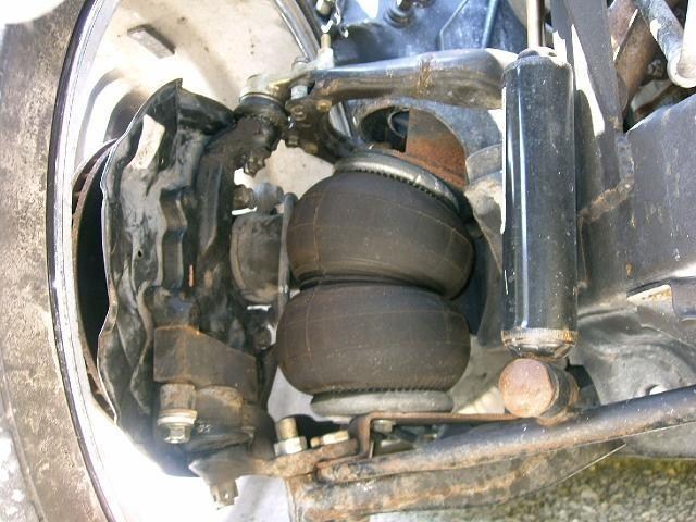

in that pic the control arm isnt bolted on, but to lay on 20s you gotta do a few things. if your using the stock arms you gonna flip both balljoints and put a spacer above the lower balljoint. for the upper arm you will have to cut it, bend it, then reweld it so it wont bind. other than that you just gotta tub the firewall and move the clutch cylinder (if manual). i think im just gonna get the control arms from kustomworks.... or make my own. heres a pic of how a guy did his to lay.
