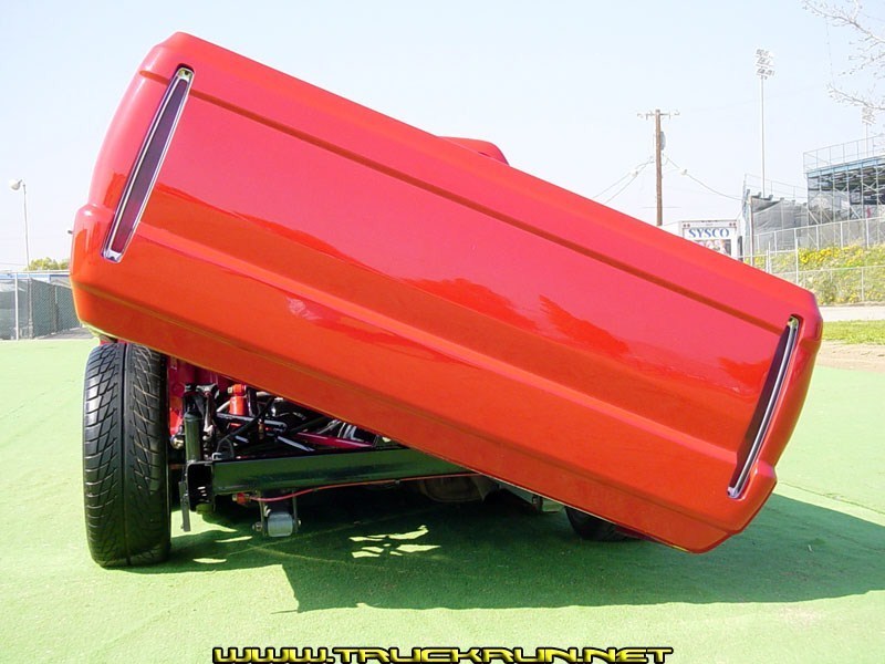

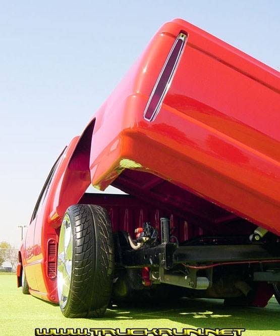

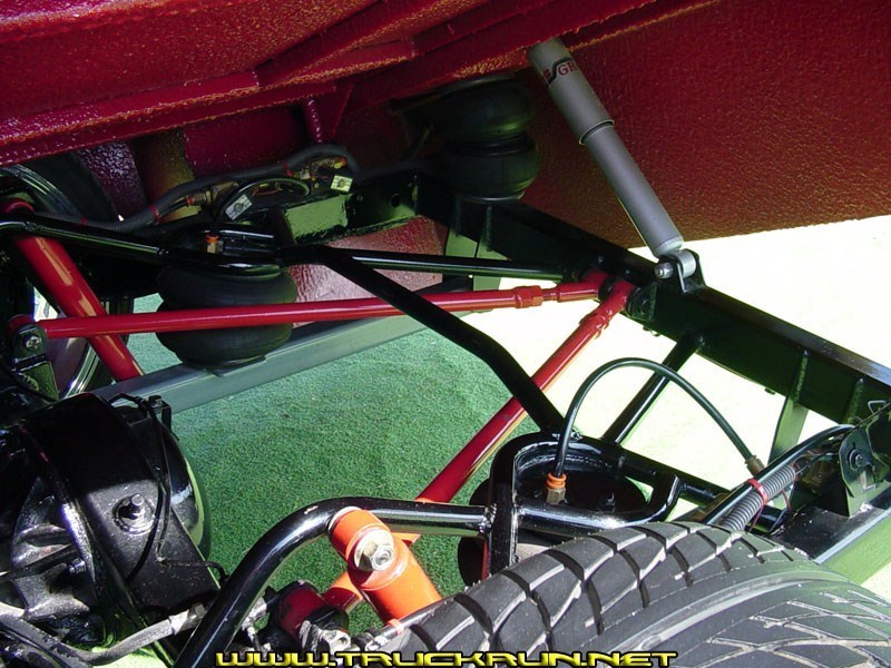

mine used air bags, a shock for stability and a cadillac trunk latch to hold it in place.

Ive always loved your truck and the tilt bed ernie. I am gonne be putting a tilt bed on my frontier, not sure which way it will tilt yet though.
