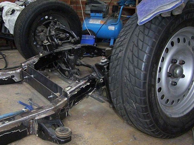

heres another good idea, found this on fabricatethis.com which no longer works but he does have a profile on here these boys are from down unda
