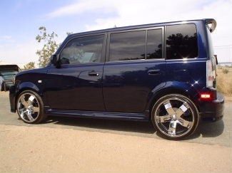

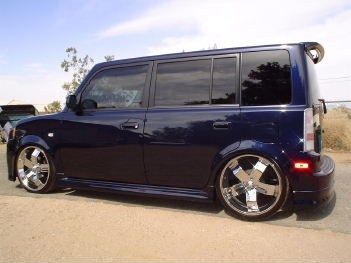

i made a kit that was only 1200 dollars that included bags, struts, valves, comp, tank, everything needed complete bolt in except for a few tacks on the rear upper cups stock shocks stock struts, its on my personal xB no noises... nothing for 30,000 mile on 19" wheels and tucks top of wheel
