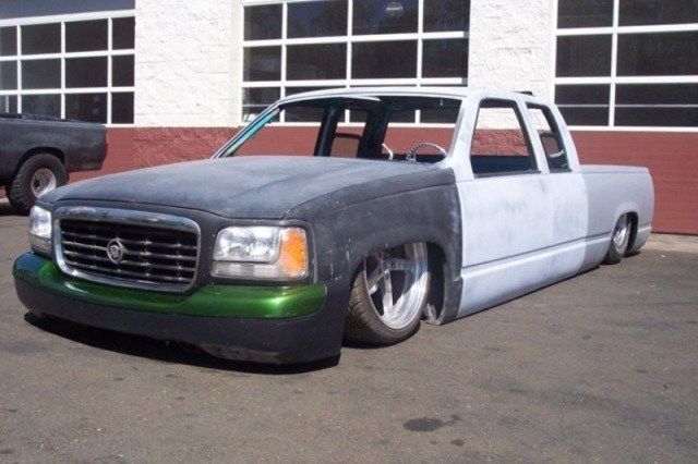

i chopped mine its a fullsize and its far from being done, I used the stock side glass and made the stock quarter windows roll down , I still need to cut the front glass and get some rear glass cut. I dont know how to post pics nor do i have tome to figure it out check my profile, its chopped 2.5 and the pillars were laid back to match the chop, for the quarters i used alot of parts from a suburban rear door for seals etc.

msturg
his^^^^

The back cab windows rolling down is a sick mod......good work!
