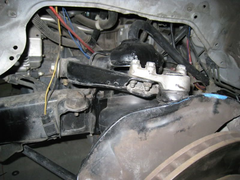

Can anyone post any pics of a front end bagged with stock arms and strut rods. It looks like the strut rods would hit the steering.

they do when you try to turn while laid out or real low

just finished redoing this today. stock arms rides great. Those wires were just hanging there during the picture none of them are still there hahaha
