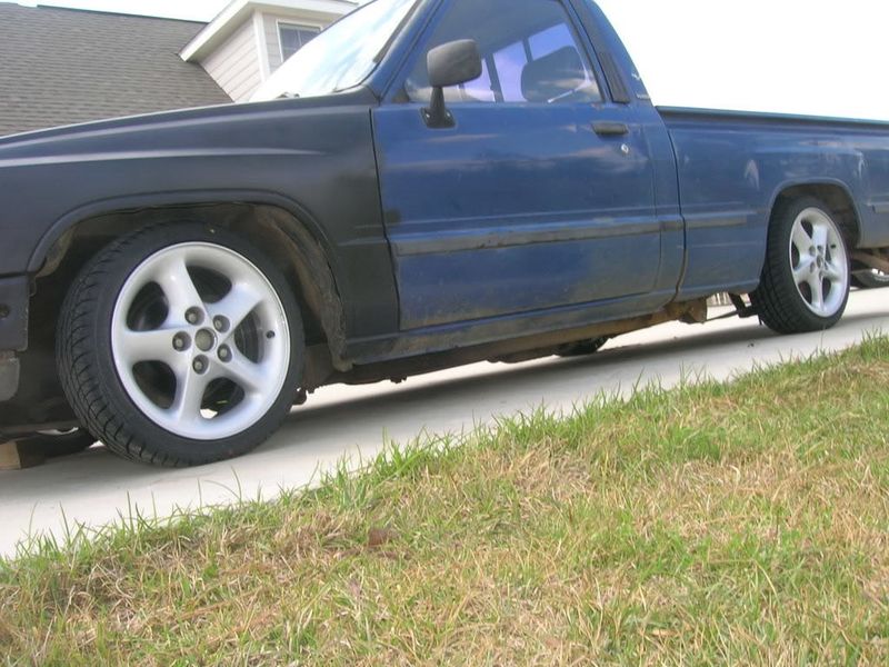

layedout72
thats my truck with the static drop i had. no spindles, just torsion (un keyed). from what i understand re-keying them sorta relieves pressure and allows a bit more travel. someone correct me if im wrong. my truck rode just fine, didnt bottom out, and i loved driving it. thats how it would sit on 205/40/16's just so you know what size those are.
