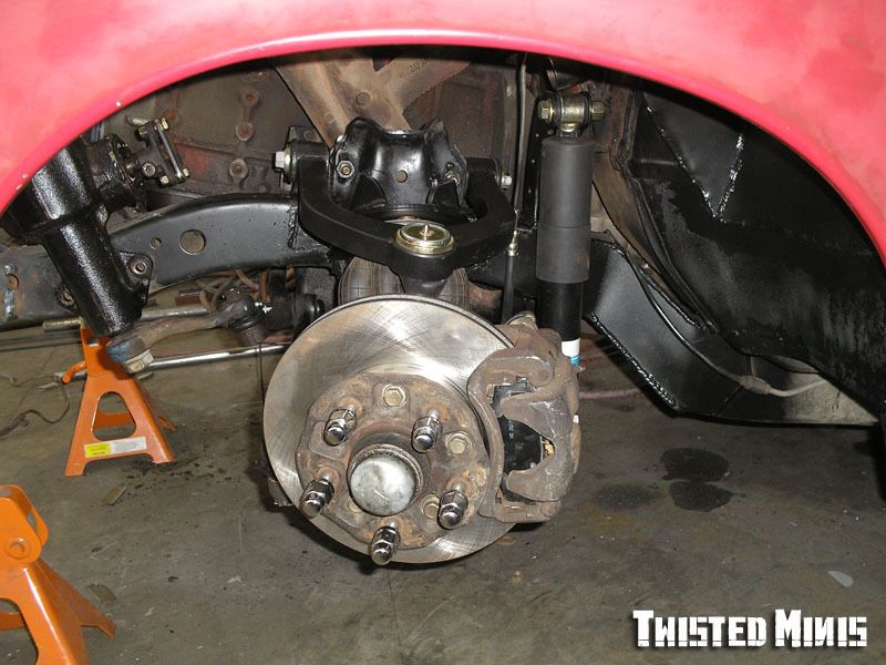

If you just want to lower it, not necessary. If you want to bag it, then yes. You need to understand that you will be limited with how low you can go with the stock suspension you have right now.
And by clipping, yes, I mean swapping the suspension out. Here is a Datsun I clipped with a Toyota frame.
