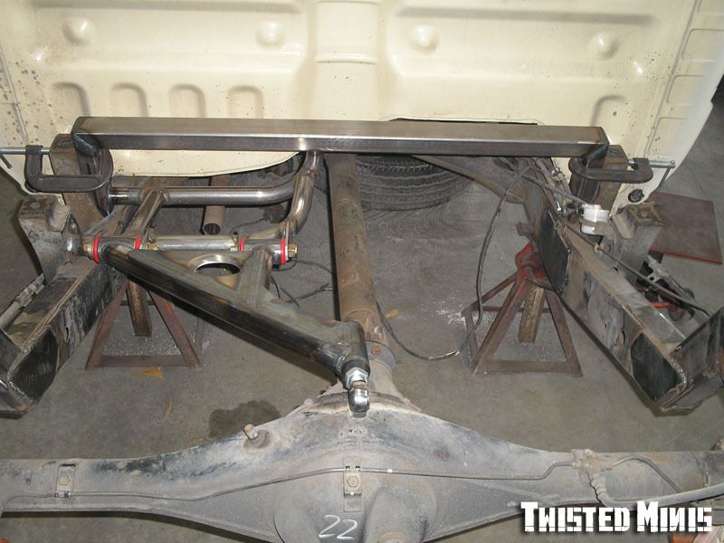

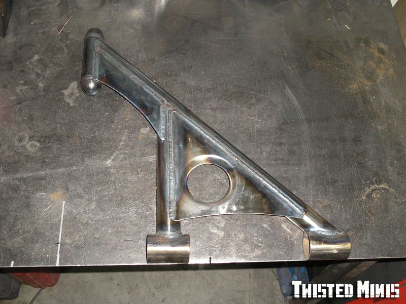

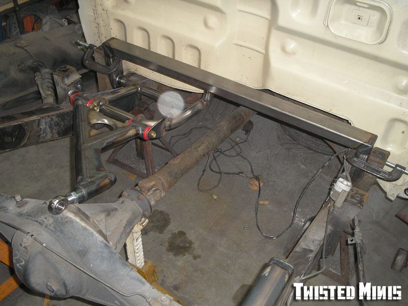

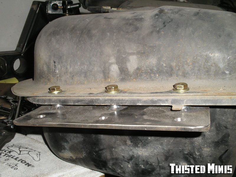

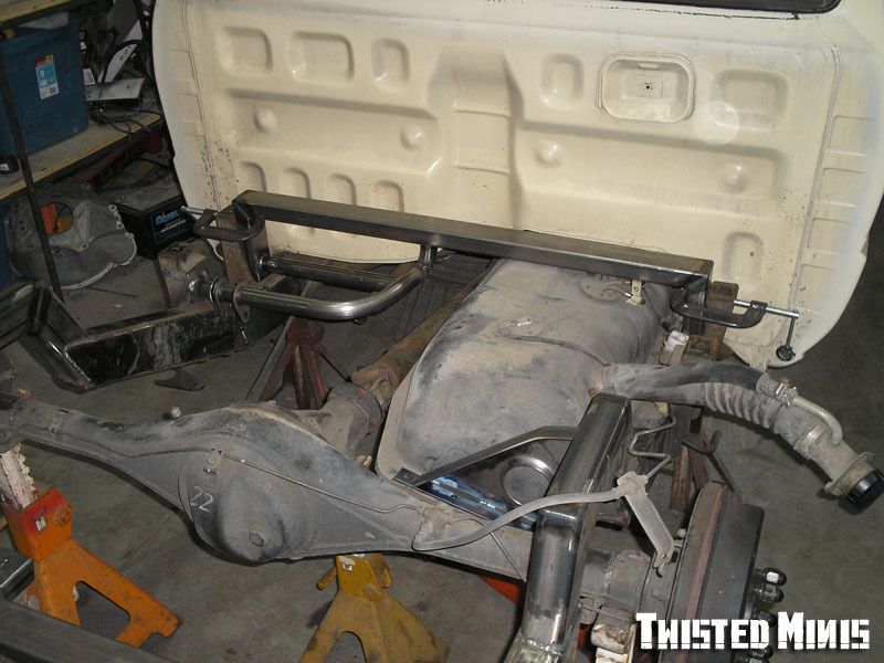

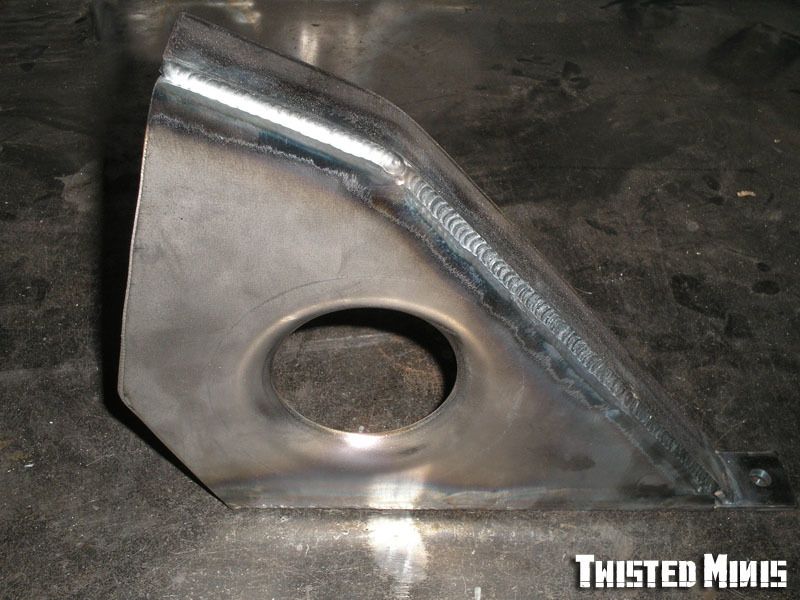

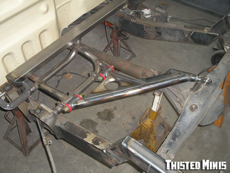

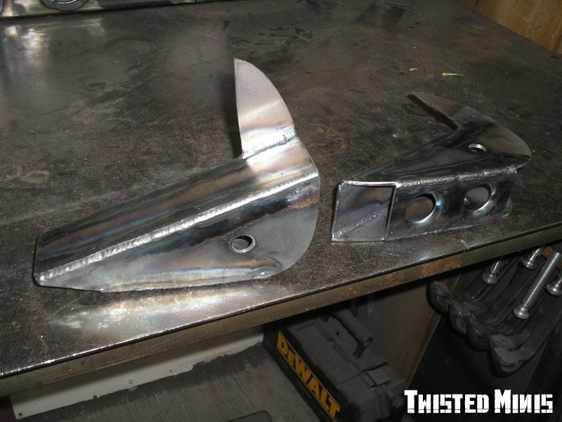

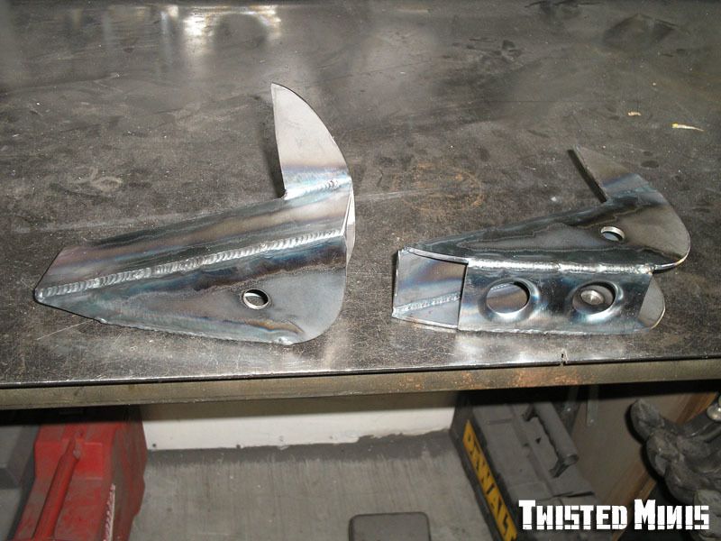

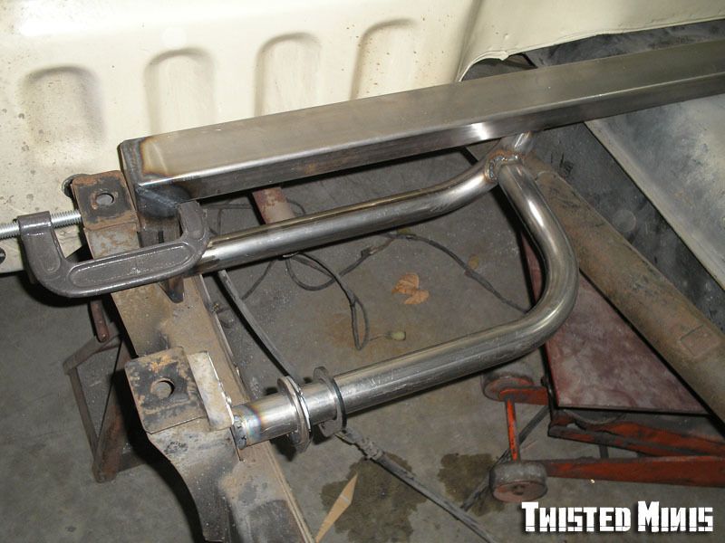

I guess you could say it will be similar to the SD 3-link. It's a similar design, but it will be a more involved install. I don't feel there is a safe way to design a bolt on kit for the Toyota frame, and if there was, I don't think it would look good. But my idea is to jig the cross member off of the existing bed mounts. I have a cross member built that bolts to the bed mount in front of the axle to locate it, and lines up between the two bed mounts behind the cab. The wishbone will be similar to the one on my truck, but I am changing some things to improve the design and the geometry of the setup, and also make it look better IMO. I should have a wishbone wrapped up by Monday with pictures. Until then here are some pictures of the parts I have been working on.

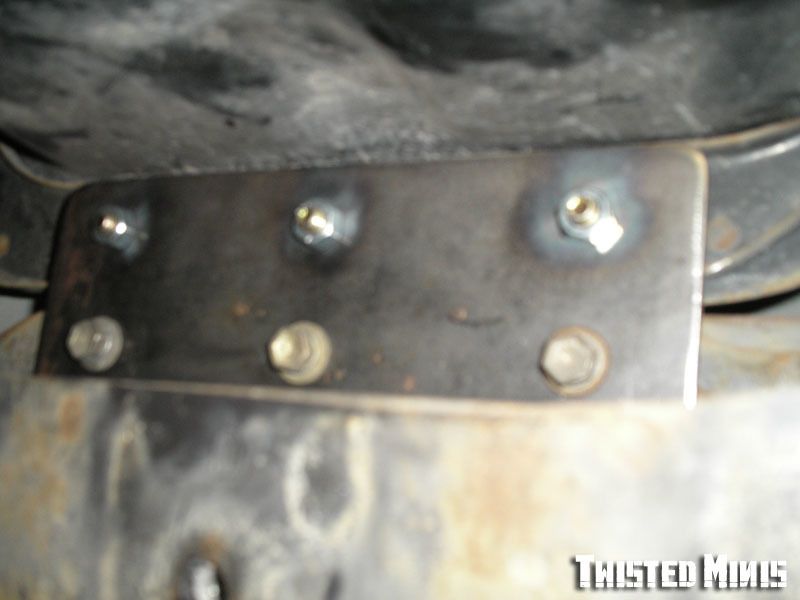

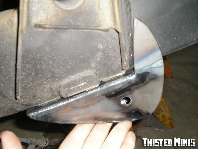

First is the tank relocation brackets. The first one bolts to the front of the tank, moves it back an inch and up 3/4" so that it is above the bottom of the frame.

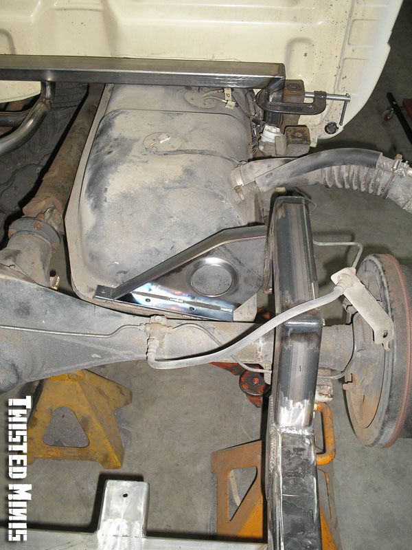

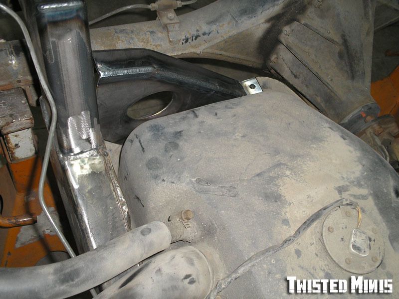

The second needs to be welded on to the frame in the notch area. I leave an extra 1/8" on it to be trimmed off, since some people will run an 8 piece notch, and some might run a 3-piece, which will make a difference in the frame thickness in that area.
And these are the lower link brackets on the frame side. They are designed to sit above the frame a good bit, and also protect the bushing from dragging.
And they will use the bed mounts to line them up. The stock spring perches will need to be removed entirely.

props on that rear tank bracket that thing looks great! I also like using the bed mount to line up the link tab.
