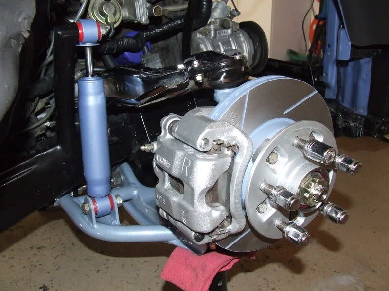

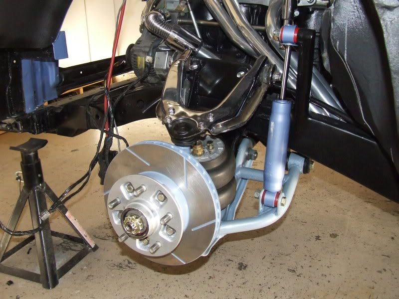

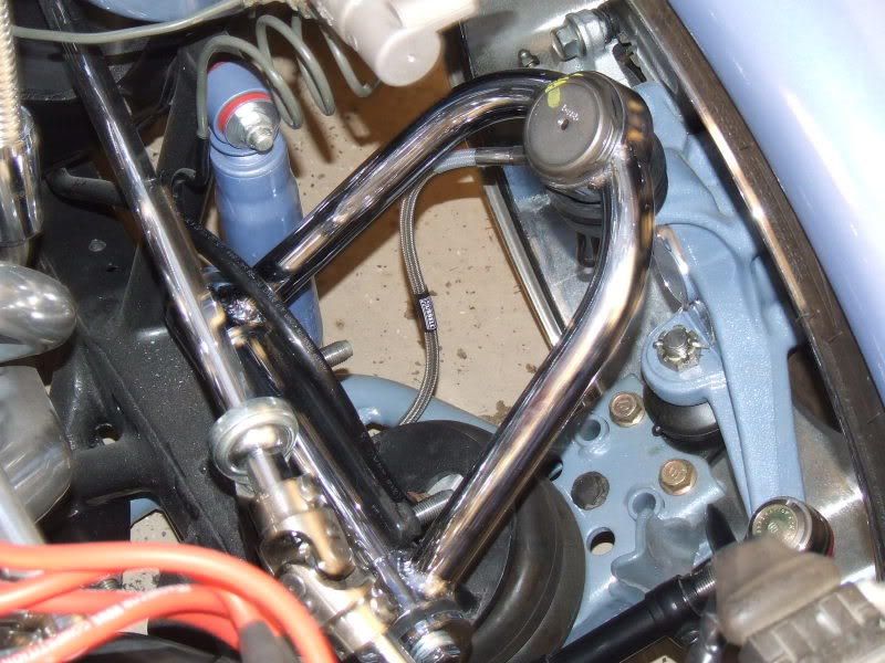

If you are planning on running those rear shocks, you will have to make custom upper shock mounts. I made mine out of chromoly tubing, and used a Suicidedoors.com lower shock-mount bolt. Of course your shocks would be located closer to the arms. Unless you triangulate your stock lowers. I would then drill a hole in the lower control arm for the lower shock-mount bolt. Make sure both bolts are running the same direction. You can see in my pic.
I have more pics of this build if you want 'em
