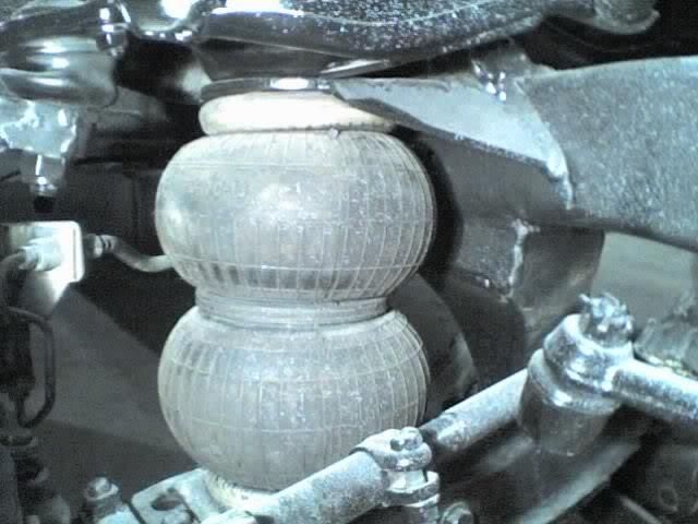

My 92 Toyota has a limited turning radius because of the front brake line bracket, where the hardline meets the rubber hose.
The steering stops are engaged to keep the bracket from hitting the air bag.
I believe I need to relocate the bracket and lengthen the rubber brake line.
I was wondering if anyone had pics/tips I could use.
Thanks 1x

See the bracket where the hardline meets the rubber line is. When I turn it will hit the air bag. That is why the steering stops are adjusted to limit the turning radius.
I think I need to do something like this...
But not sure what they did. It seems where the brake hardline meets the rubber line should be supported in this pic, to prevent stress and breakage.
Just looking for some ideas....
Thanks

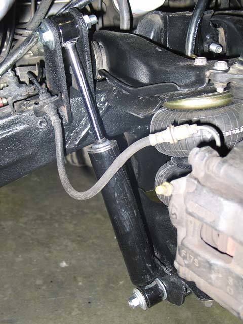

What I did,use braided brake line,& relocate the bracket @ the frame.

Cool. Nice Shocks!
Do you have any pics where the Braided Line meets the caliper?
Did you thread the braided line straight into the caliper, which would eliminate the hardline and bracket @ the caliper.
That was my concern.
Thanks.

This is the stock caliper with after market braided line,the fittings are stock
and use the stock brackets
truck action's avatar
truck action
This is the same line into a Toyota 4 Runner 4-piston caliper & larger Wilwood rotor. Had to use a 10mm male to male fitting @ the caliper,no bracket @ the caliper & just bent he stock main hard line to where clears

I am running slams and my shocks are very close to the pictured ones.
I guess my bag is mounted alittle further out than yours?

Those are some nice brakes!
I am seeing no options but to move my bracket to the back side of the caliper and using a lenghtened carrier bolt to mount the bracket.
Thanks for the pics!
