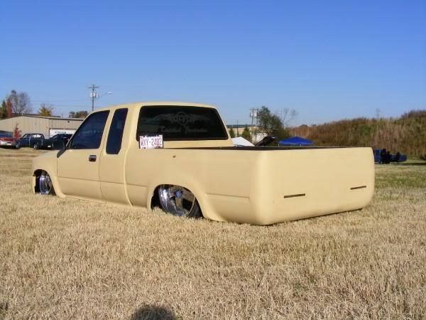

<a><img></a>
mines got 20s and lays body all i did was flip the ball joints modify the lower arm and tub the fire wall and got a smaller booster. and its stock arms and spindles...
