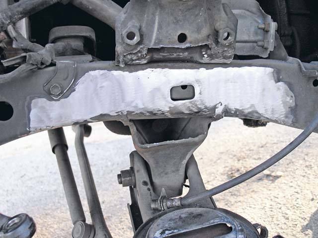

Pics of the area(s) in question would be most helpful in a diagnosis.

only on mine the bracket for the upper contorl arm has been cut off as I'm using custom control arms that mount with heims rather than on a cross bar.

Here's mine. CanDo brackets and CanDo arms. Basically custom, not a million of them out there. Anyway, Cut the crap off my frame, like your pic. Plated the hole. Welded the bag plate on after trimming down. Welded on gussets. If you're not hopping this truck, this is more than adequate.
