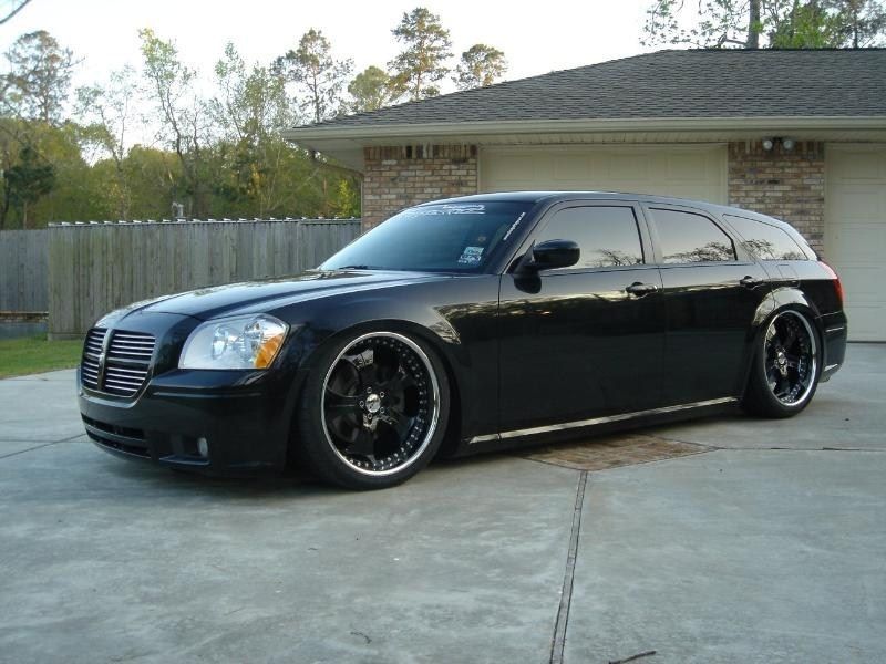

was thinking of buying one of these soon but am trying to find out what the biggest tire and wheel i could put on it. i so far have seen that 22's are the biggest. any one else

I think you'll dig 22s with 1.5" drop.
Feels nice. Tighter than stock... not too bumpy. Looks bitch.
You may wanna look at 20X8.5s up front and 22X10.5s in the back. Not even drop it in the back. I think the raked vipe would look good on a Charger.

You can fit 22's without a problem. I roll em and only rub when I lay it out... and there was no cutting of the fenderwells.

Nobody makes a 23 in a 5 on 115 though. I have a 300 on 22x9.5 with a 265/35/22 tire and +15 offset. Eibach drop kit and no rubbing except when the back seat is loaded down and i go over a speed bump or sumthing like that. Go to 300cforums.com and youll find a lot of helpful information about the entire LX platform.
