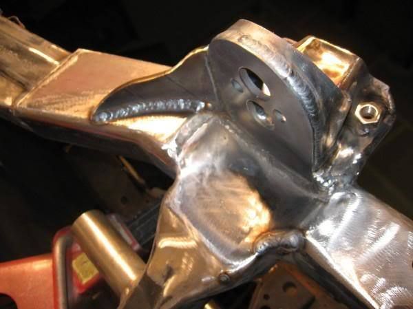

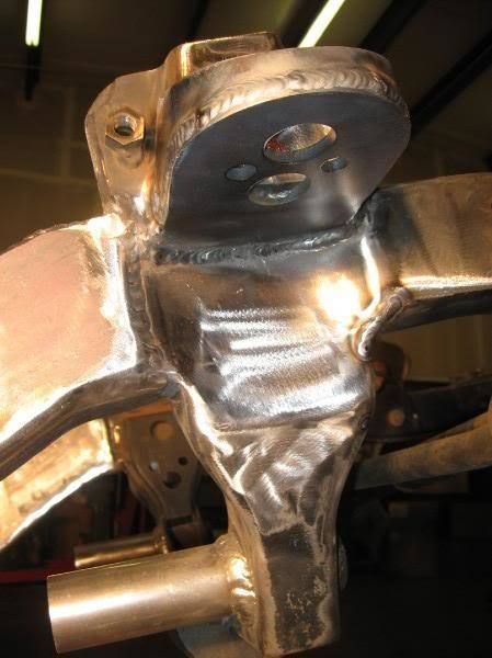

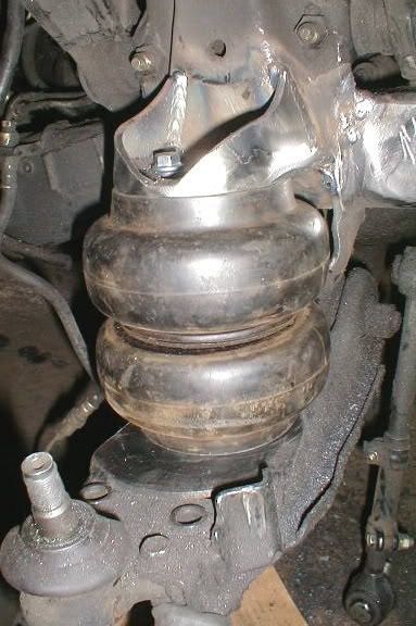

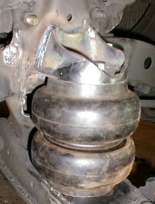

ok im sick of searching. . . does anyone have pics of there front bag brackets on a stock frame. oh yeah my truck is an 84

thanks for the pics they will help a lot

All those pics are of the CanDo Specialties front bag brackets. Steve the owner of CanDo went the extra mile & notched out the frame some on the second set of brackets.

Slam Specialties RE 200 PSI Single Port-(size 6), but if you notch out your frame some in the front like Steve did then you may be able to use the 7's!

yeah i planned on runnin the 6's would i have rubbing issues if i didnt notch the frame or do i have to regardless

You don't have to clearance the frame for RE6s.
