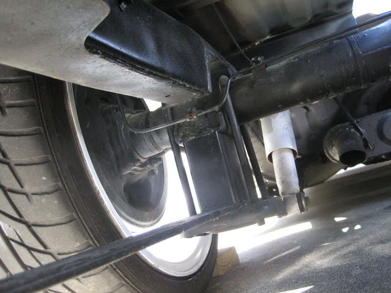

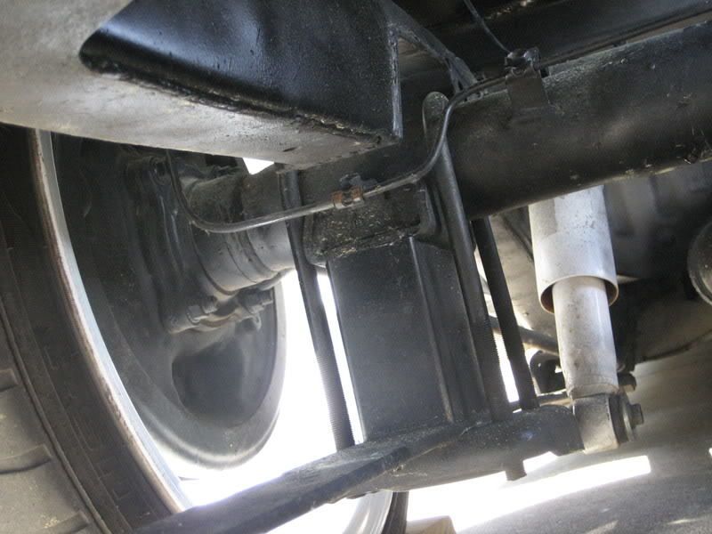

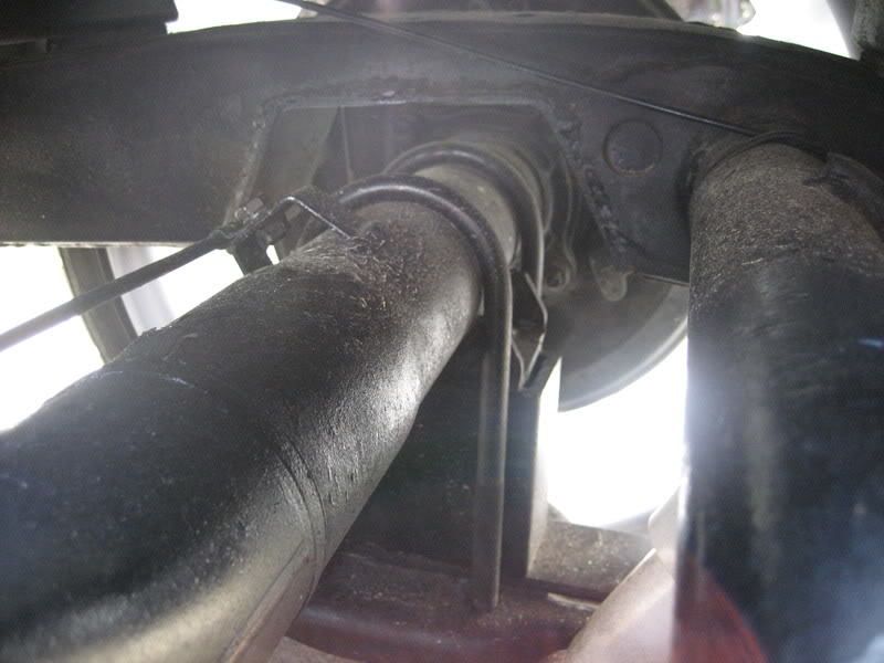

Ok...this is what Im running on my 91 model truck. Now keep in mind that all this was done over 8 years ago lol. Pics are decent, but they should give
you an idea on what Ive got...

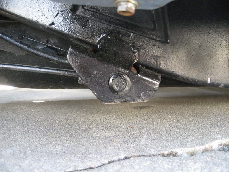

Ive got a small c-notch, 4-inch angle blocks, airshocks & yes Im running a momo-leaf as well too. I also raised my front hangers too cause I got tired of dragging through the leaf springs. Oh another thing I did too was replace my 2wd leaf springs with the ones out of a 4wd. You can tell in the pics that the front of them where the mount sit higher.

Can you mono leaf a stock set of leaf springs or do you buy them.
vegasyota94's avatar
vegasyota94
you can mono leaf stock leafs... i did to mine when i had leafs
framescr8pintoy's avatar
framescr8pintoy
and have it dearched at the spring shop
S8
sickyota 808
SMC, is that only one leaf in the back, man thats scary.. is this the pics from your blue extra-cab, if so man this truck was slammed for one static setup..
