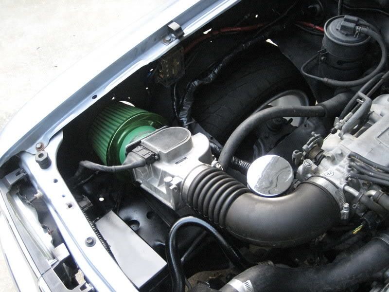

Ok...when I had my truck in the shop getting the new motor installed me & my friend relocated the battery to the bed & we also moved the air filter off the the side out of the way. I got the intake adapter kit & a cone filter off ebay & it works great. Here is a pic of mine...its not permanent because I got some intake pipe & plan to have it painted to match the truck. Oh & as for the battery...I just got me a battery box & the biggest battery that Advance Auto Parts made for my truck cause Ive had nothing but bad luck with Optima batteries. Hope this helped.
Nothing fancy, but it gets the job done!!

you got what portion of that kit? what comes with and how did you search for it

I just dont like Optima's cause they just seemed to be over priced & when they get weak/low after awhile they dont seem to work all that great even after you recharge them. Might just be me, but I like the regular batteries & you can get a metal box that locks just to protect your battery. As for the air adapter kit I got it off ebay...here is what I got.
I wasnt a big fan of the filter that came with it so I just bought me a universal one from the local parts store & sold the other one lol!

agreed i really just need that adapter and thats the one iwas thinking so i wanted some feed back on it
WAS it that specific seller?

I cant remember what seller I got the adapter from...just make sure he/she

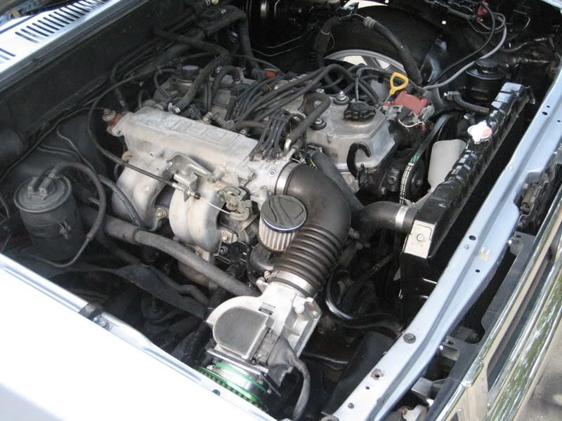

has a good feedback record & youll be ok. Oh...my truck isnt bagged yet & in that pic Ive got just enough of the inner fender well cut out so it wont rub so bad when I turn. All Ive got done to the front is DJM 3-inch lower control arms, reset torsion bars, fliped ball joints & drop shocks. Got any more questions then feel free to ask & Ill do my best to help. Here is another angle of the intake...
