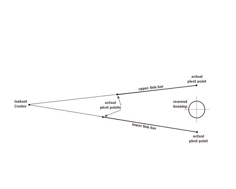

cheers seth.. one more question tho, is the distance between uppers & lowers very important? or is it whatever it is?
twisted minis's avatar
twisted minis
Yes it is definitely important. The distance at the axle, versus the distance at the frame determines your instant center.
