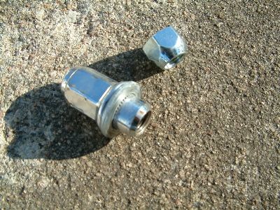

this is what you need:
these have a tendency to cause wobbling:
what kind of lug nuts are you using?

the pickup rims are hub centric. they are centered by the hubs. the supra rims are(most likely) lug centric. you have to have lug centric nuts to get the centered on your hub. the stock pickup nuts will not sufficiently do this.

Trust me im using the hubcentric lugs and the bolt on spacer .
