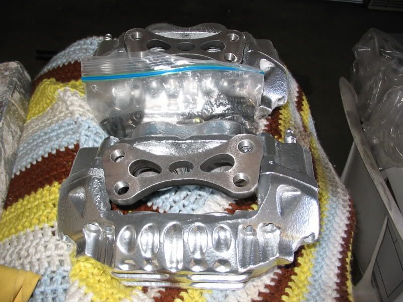

Im finally able to get some bigger brakes to stop my truck faster and way better. I'm useing 4x4 calipers, with wilwood rotors n hats. i will be installing the brakes on saturday n also flushing the brake fluid, which is recommended. so i will let you know how it goes....anywayz here are some of the pics....

nice. no slotted?
where are the brackets from?

custom made brackets from a guy off toyotaminis.com
