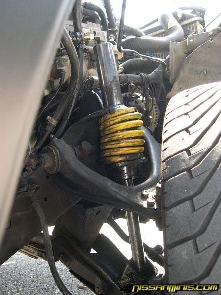

psycopathicryda
This is a pic of my old truck in the front (its a nissan) torsion bar set up.
I reinforced the crossmember with 3/8 steel plate.
