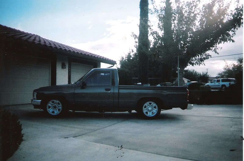

its not really that bad if you only lower it a few inches. the guys that take them all the way down and ride on bump stops is where the super shitty ride comes from. when i lowered mine it was just a few inches and it rode fine.
back in the day when i lowered it at first.

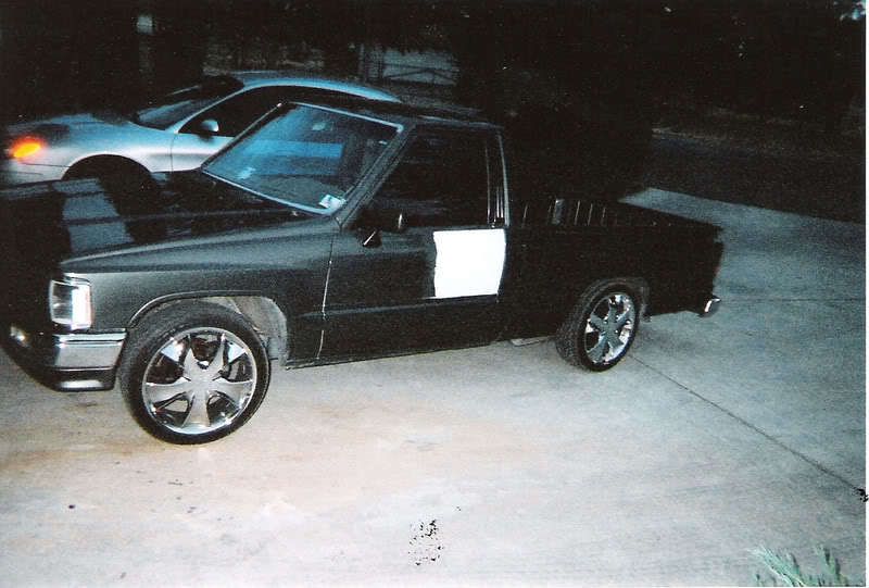

after i got my wheels i cranked them up a little bit cause i liked the front higher than the back. the ride difference wasnt really noticable.

they were off a taco, the wheels i had on it originally, the offset pushed the wheel slighly outward so i couldnt lower it. i traded my brother my crager wheels for his stock ones so i could lower...it was a win win for both of us.
