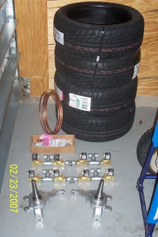

Got some of the new toys today...
4 new shoes Nankang 17's
8 new ASCO 1/2" Valves
2" Dropped spindles (thanx again slamdtaco)
2 new water traps
all new plumbing
Hardline from all 3 compressors to tanks
3 check valves (1 per compressor)
new front brakes and wheel bearings
Hope i have it back together in time for spring fling.....
