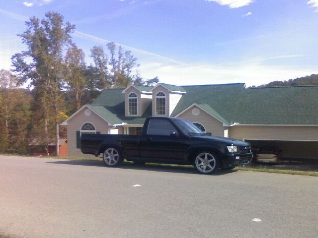

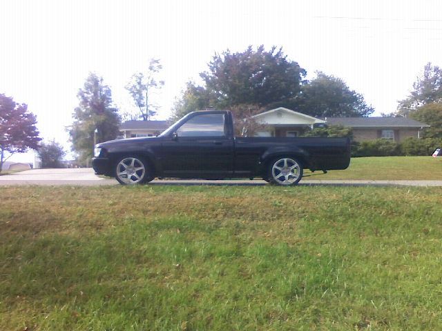

I just dropped my 88 with spindles in the front and lowered leafs in the rear. So right now it has a 2" drop in the front and a 2" drop in the rear. Can I do a 4" in the rear with out a c notch or just a 3" and remove the bump stops? I am going to drop the front 1 more inch by tightening the torsions. Please let me know my options in the back. Thanks

You need to do your research before you touch your truck...
First things first, IF YOU TIGHTEN THE TORSIONS you will RAISE the truck..
Now then, you can lower the back with 3" blocks, Pull the middle leaf and that will put you at 4.5" drop in the back or you can use 4 inch angle blocks..

well I put 2" lowered leafs in the rear for now so will I be able to put a 2" block in the rear with out c nothcing the rear for a total of 4" in the rear? I am just wondering If I have the clearance fromt he axle and frame?

No you dont NEWB...
You can have a 5" drop in back as long as you take out your bump stops, and you will still have plenty of clearance.. If you bounce hard it will bottom out on the frame..
Before I bagged my toyota I had a 4.5" all around.. and it was fine
