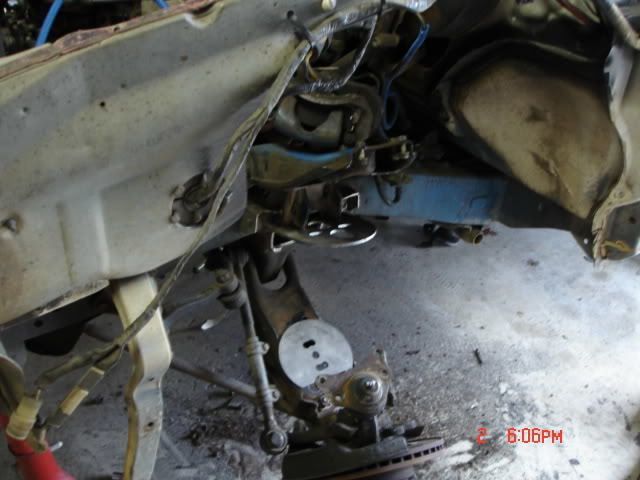

hey guys im baggin my 93 yota and im wounderin behind my top bracket would i have to reinforce that beam that hold the front bag bracket i did my set up like the yota from why not fab please any one help me out il try too get some pics soon peace thanks guys

just weld some gussets on top of the bracket.

there maybe a pic from when we bagged mine this weekend check the photo post under lotoy86 front bags theres just two gussets that brace it.

You dont need arms or drop spindles. If you've just got 18s or smaller, I wouldnt recommend drop spindles, the camber looks cool. But if you're going for 20s, drop spindles will keep it moderate.

So if you don't need any custom components to slam the front, I guess you just mount the bag plates like in lotoy86's pic? Is there any reinforcing done to the stock components? What about the torsion bars? Can you still junk 'em? I thought you needed to buy control arms? or am I getting them mixed up with 'A' arms?
