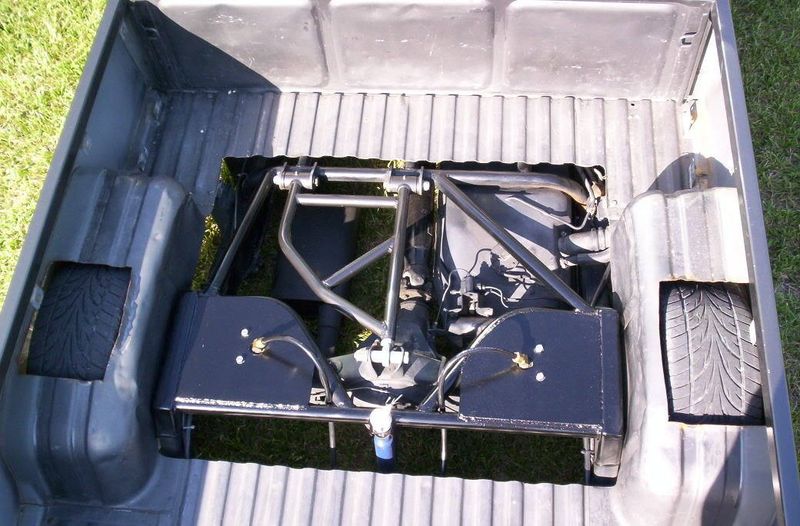

2lowtoy
DO what i did relocate your gas tank to the rear frame. and run forward.
sitnlow4life
Dude thats awsome info
Do you have any pics of the set-up?
