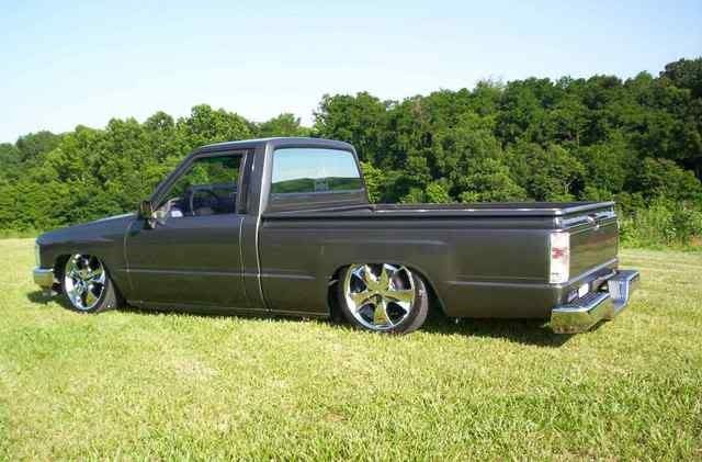

i would stay away from reverse four links also, a good clean reliable set up that allows you to get low and still not to move the gas tank would be a three link...ill show you a picture of my 88 and how it was bagged in the rear.(ill go take some pictures today and post em up for ya) also, seth (twistedminis) bagged his truck similar to mine only he mounted his bags behind the axle where as mine are on it. neither of us had to move the gas tank but you'll have to move it up a couple of inches so it dont drag. if you notch your frame and keep the mono-leaf there it will get down as low as the shackle touching the ground...but like the other guy said a mono-leaf system isnt the safest in the world i wouldnt reccomend it either. plus is rides pretty rough.
p.s. i tuck 17" with 215/40/zr17 i was having a problem rubbin on my wheel wells in the back when rollin nose bleed but laid out it touched a little bit.

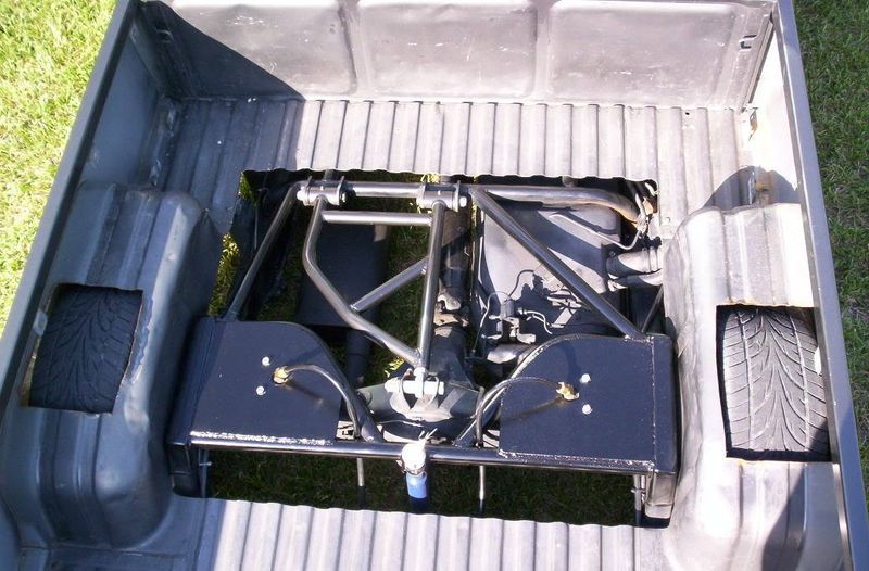

here is that pic i said i would post...its a three link with hymes for side to side. i cut the tops of the fenders so i could drag it. im gonna start tubbing new wells in a couple weeks. the gas tank is in the stock location only it had to be moved up a couple of inches so it doesnt drag on the ground.
