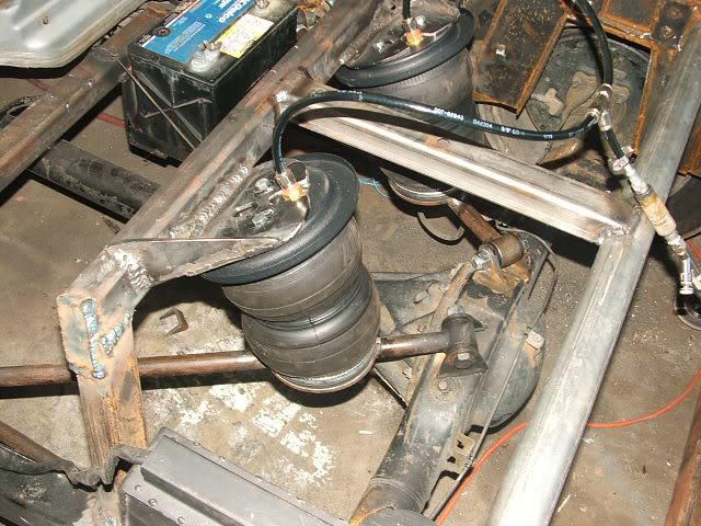

modifydtoy
here is where i put mine. hard to recomend any place- depends on your susp setup and where u have room.
and amp wire should be allright as long as it is at least 4 gauge.
vegasyota94
thats crazy.. i never seen a setup with the bags welded up on the 4 link.
modifydtoy
it isnt even close to being done i still have alot of bracing to do on the x member and build braces for the bottom of the link bars.

without tryin to judge your truck, do those link bars bend under pressure, are you gonna gusset them ? just curious
