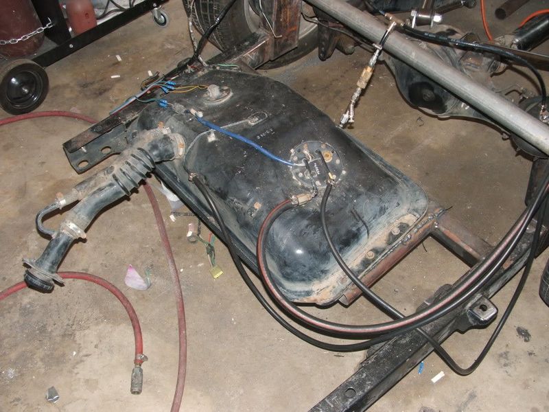

This is my set up. Forward 3 link, gas tank in stock location, very little pinion angle change, and the bars are parrallel from 3"to 8" ground clearance. Also have two lift bars in the rear. I like it.

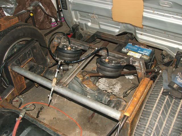

modifydtoy
dammit seth-i dont want to even show mine now,lol oh well its under construction!

Lol, whatever dude. I like the way yoru bags are mounted. Bet it will ride pretty good. Brace the bottom of those bars maybe.
