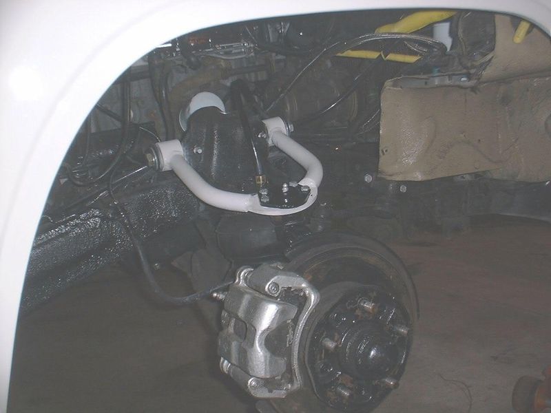

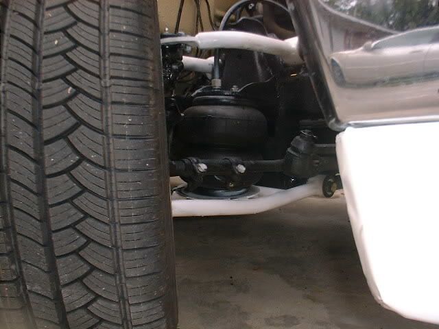

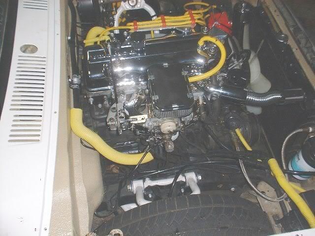

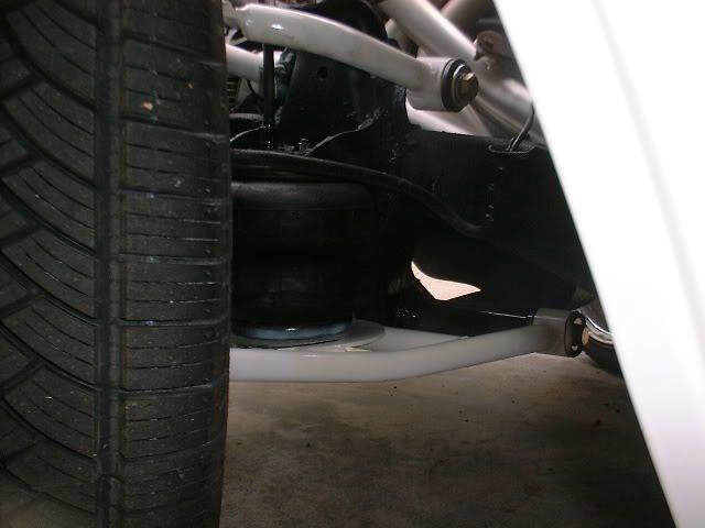

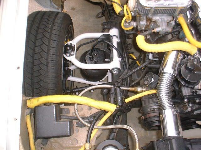

I think tubular would be the way to go on that suspension.....for the flexabilty of motion and you can get more lift cause of less binding....lemme know what pics you need Ill snap um for ya.
Maybe some of these will help

Sweet man thanks for those pics! what size bags are those? i was going to run a 7" slam bag. do u think that would fit. What all did u do to the front when u bagged it? what all did u get rid of. Could u kinda walk me through it. I have an idea, but is there any little secrets?

I triangulated my lowers, to eliminate the trut rods, and save money on buying control arms.
And I made my own uppers.

Those are 2500lb bags...Yeah that slambag should fit.Youll have to notch out the frame and do a little bit of modding but basically its pretty easy.Ill have to get ya some more pics of everything so you can see how its done......infact.....someone here on the board did a walk through pic by pic wasnt that whynotfab?I think it was....
