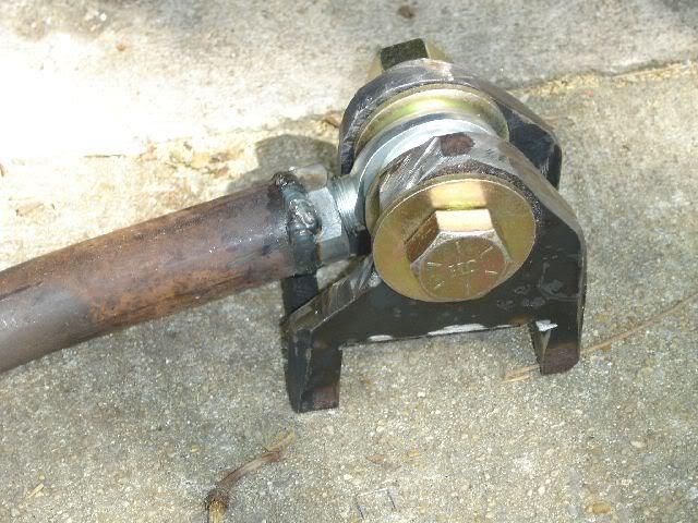

finally got around to starting on my tubular uppers...using 1" od dom tubing, im not sure on how i want to make the mounts tho....if anyones made some, or have and comment on it post..im thinking either poly 4 link bushings or heims joints...ill post some pics of them later

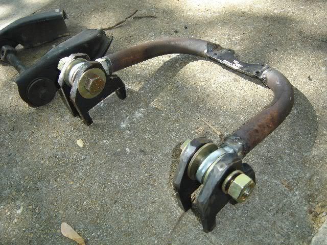

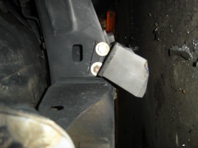

those look good twisted, but my prob was the oem mount ripped off the frame so i had to make new ones, the way i made the setup, i think it will work out, i just need to make a dust sheild for them
but to give an update, the arms are made, i just have to grind a lil more to cleam em up to fit just right, and the mounts for one side as of now are made, all i can say is these mounts should hold up much better than stock, ill post some pics of them today if i get time

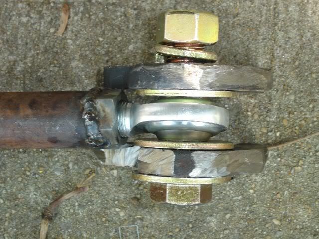

well photobucket finally let me upload, they are raw lookin in these pics, still not completed but close...

twisted minis
Those are pretty cool. I like the mounting tabs, beefy as fuck.
