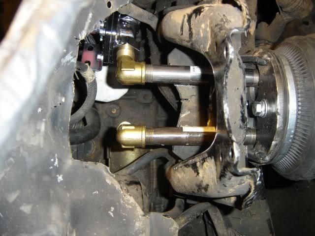

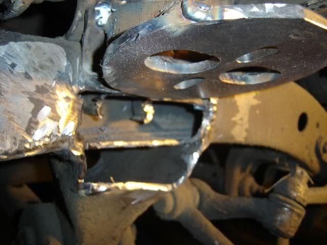

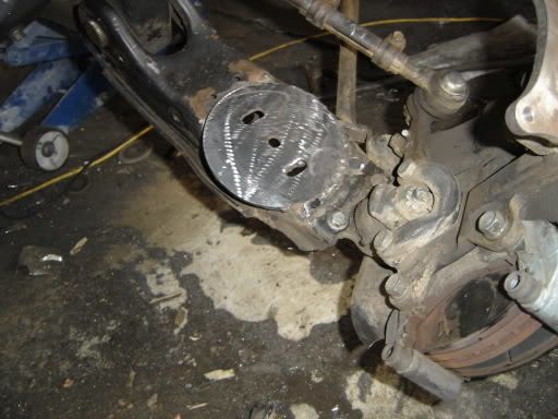

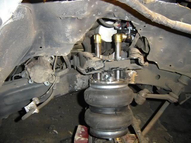

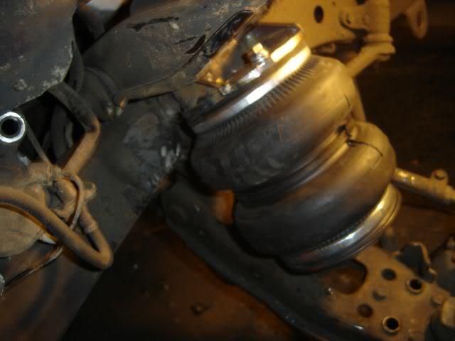

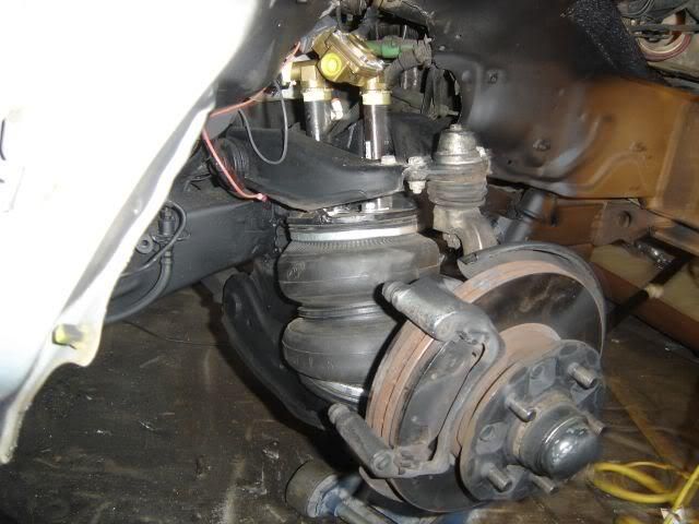

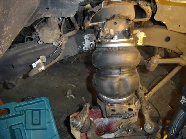

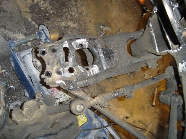

well im puttin some 2b7s in the front of my yota now, havent seen anyone with em yet so i decided we need pics of the install begginning to end....so ill post up as i get along....tell me what ya guys think

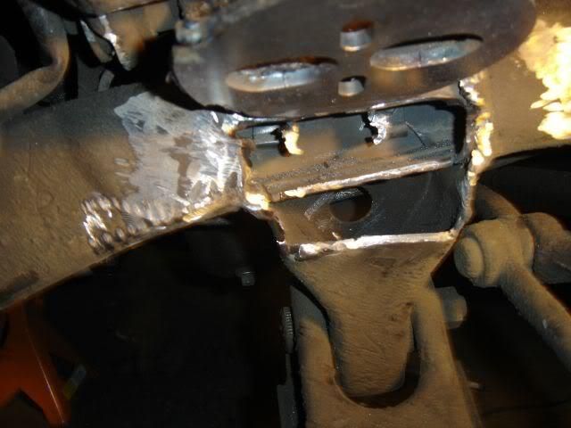

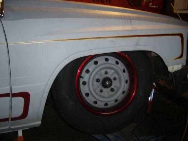

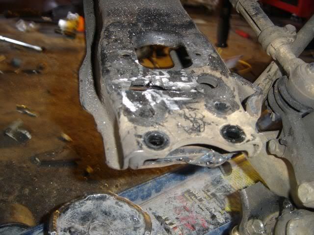

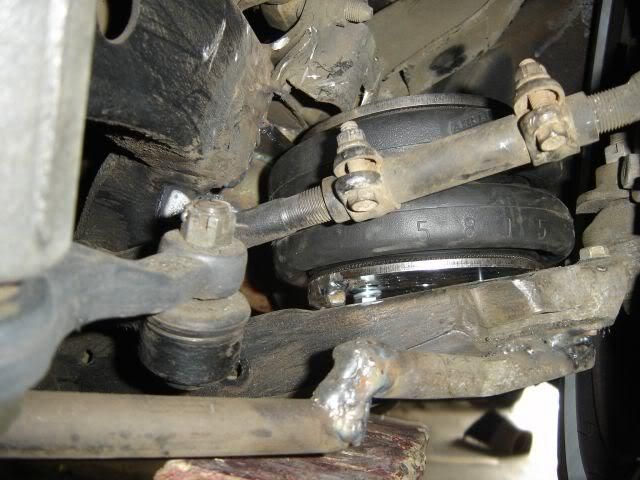

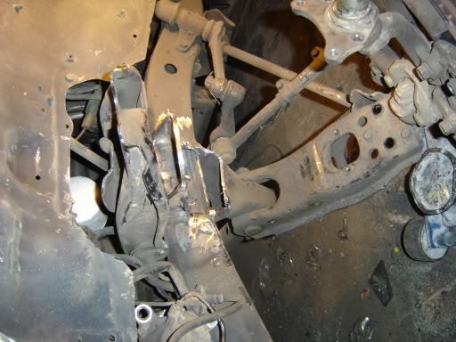

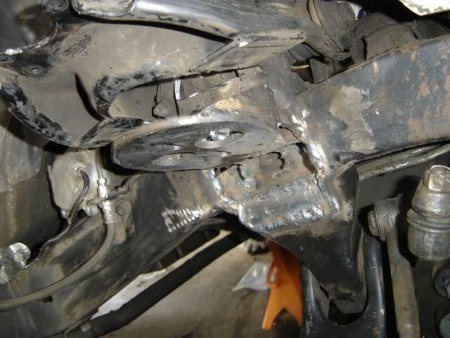

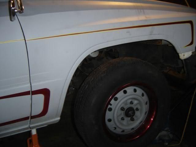

it started off like a simple install but i had to nothc the frame a bit as seen in the pics, then i had to weld the radius arm to the lca to eliminate the bolts for the bag to sit better and help me lay... new pics will show more cutting, but i also had to chop the rear bolt off my lower balljoint so i can get to the lower bag mount bolts. my uca is hitting the bag mount, so i will be making new tubulars to clear. the pics of the tire on shows it laid and almost full lift...so the advantages of these will be HUGE...

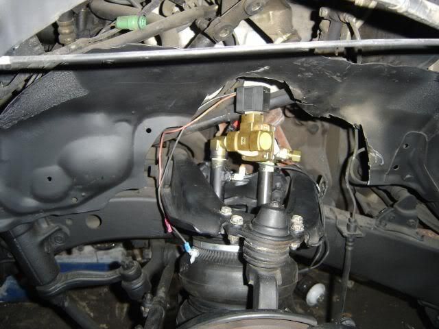

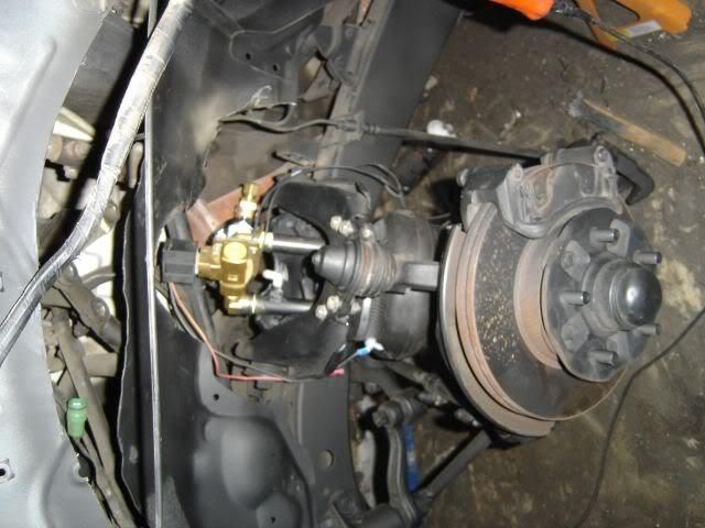

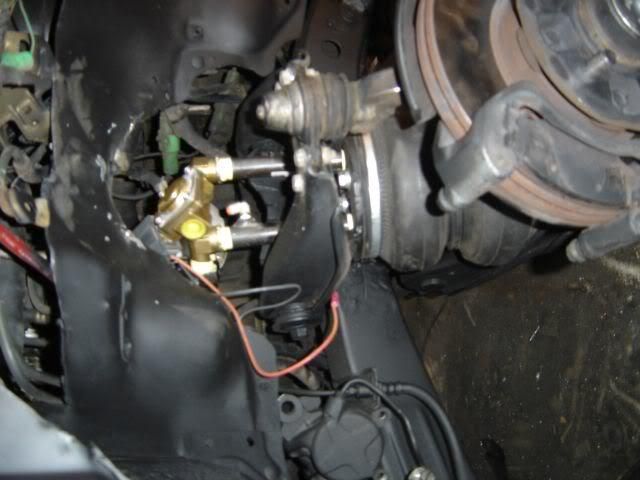

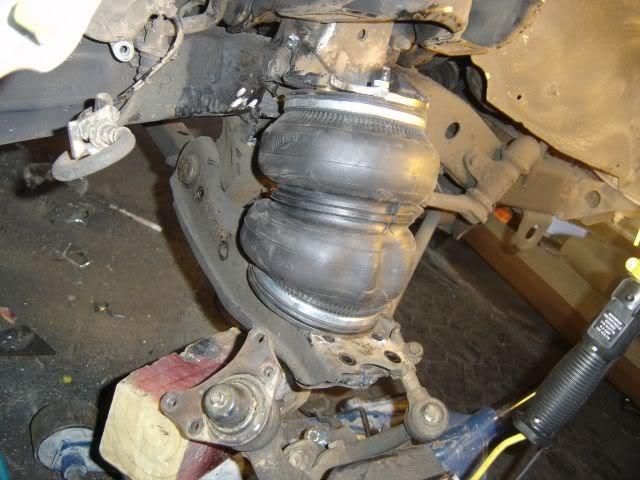

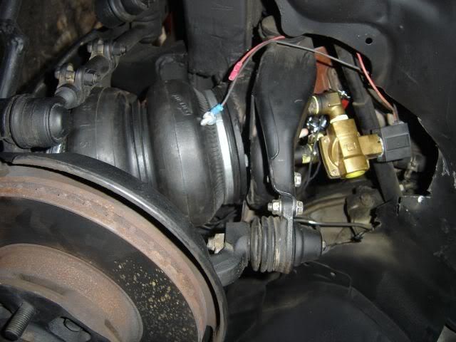

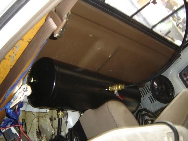

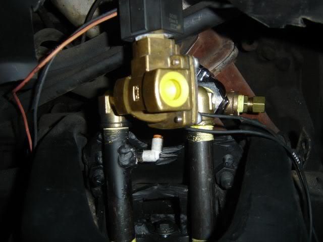

well its time for updates, tell me what you all think...
truck action's avatar
truck action
Plumping pipe??
shaved dime's avatar
shaved dime
yea, running valves on bags, hardline makes for much more insurance in my opinion, ive had too many lines break on my s10

well shes all ready...just fixin leaks...hope this post will help some...heres a link to the photobucket on it...
