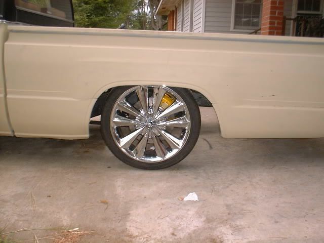

oldsklminitrk
Now see I moved that porptioning valve to the front.......but reasoning being I used a older style one I think off of a 82 that is directly under the spliter....and I also have disk brakes in the rear so I needed it.

Rodney, how did you adapt discs to the rear? Did you buy a kit?
oldsklminitrk
no it was all hand built......infact LC engineering is looking at purchasing the plans from me...so if that falls through I can hook you up with the plans and the parts.Basically everything is a stock part but the fun part was researching and buying and ordering a shit load of parts,thank god I work in the parts business and in free time measure and search for that stuff.Lemme see what LC says cause Im not suppose to discuss the parts in the kit.
