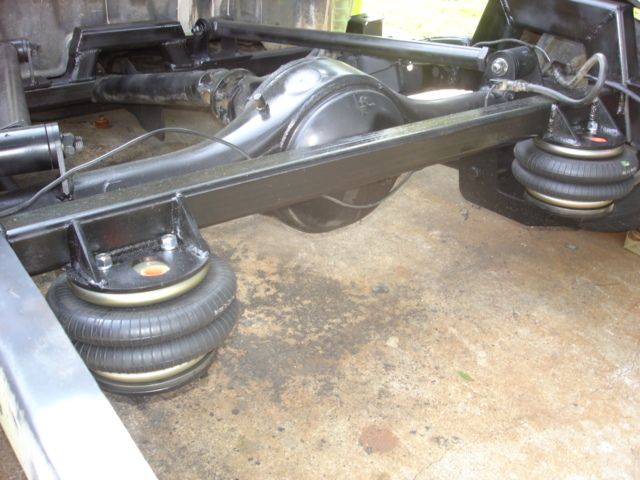

Trying to find photo's of rear bag set ups behind the axle,& is anyone useing sleeve type bags. Also shock set in this type of set up.

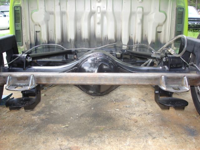

Here's a pic of a hardbody I did with behind & under axle brackets, that actually doubled as 4link brackets as well. Basic concept would be the same on any truck,
theyre not sleeve bags, but im sure you could use them, would just have to space the brackets accordingly

Thanks,thats the way I was planning. We plan on doing the same thing with the rear link mount. What about the shock mounts? I was thinking off the side of the lower bag bracket, & angle the shock forward or rearward,not straight up & down.

Seems like that'd work, be sure to post pics once you get started!
