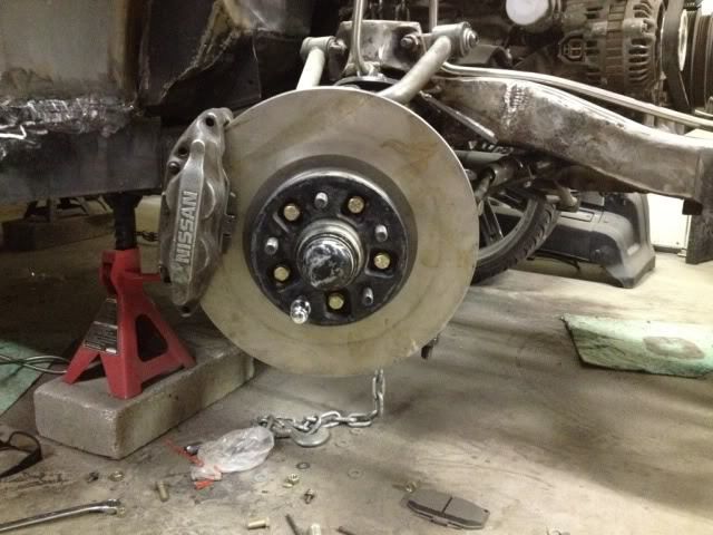

yo im gonna go ahead and dig up my post from forever ago. but i did something you guys might want to see. lol.
this is ona 84-95 drop spindle. i took a 350z front rotor. and had a machine shop redrill and tap it for the rear of the toyota hub. and then i used a 300zx 30mm caliper and made my own brackets. and bam! there it is. i had to grind a little off the front of the caliper so they would fit. but it was pretty easy. i cant find any more pics of it though. :/
its a 13in rotor. and you can get a drilled and slotted set off ebay for like 100 bucks.

@hunterw im having a hard time using the toyota 2" drop spindle from a 86 yota I think. the only problem is the mazda lower ball joint don't wanna fit it nice withevthe toyota drop spindles. any advice on what you used? the ball joint babgs against the spindle and doesn't want to sit in at all
