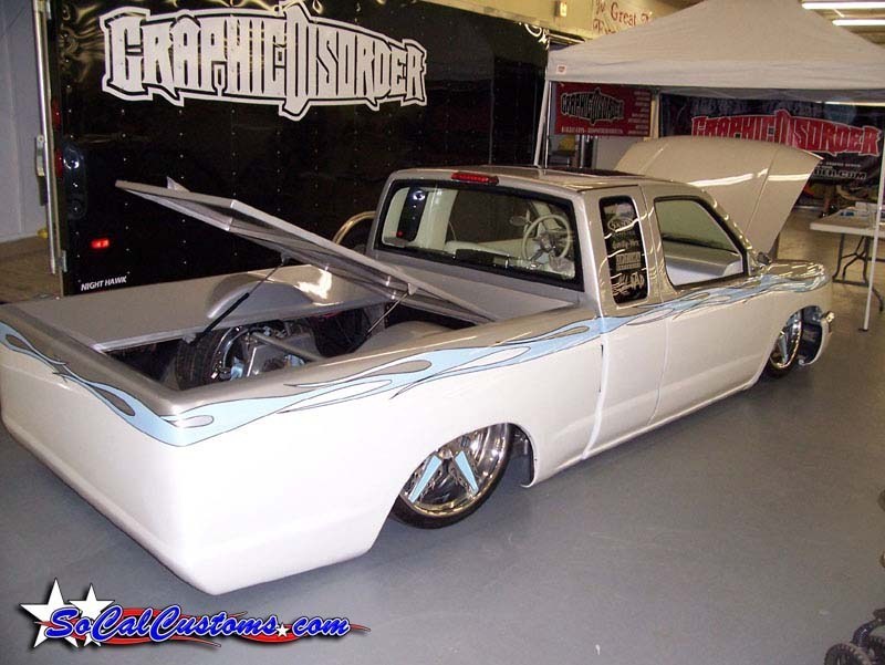

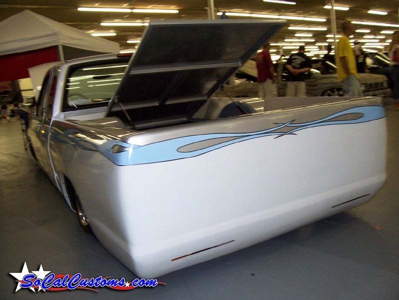

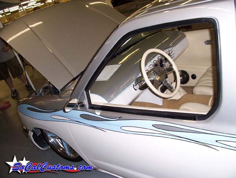

Here's Brandts frame all painted up and gettin ready to go under the body,
done at 3D Kustoms # is 276-393-1422
-Stock Floor BD. Full Frame, not just firewall back.
-Scotts Hot Rod Mustang II front suspension.
-Covette rear suspension shortened 5 inches per side.
-2 optima Yellow tops
-2 Viair 380s, 8 GC 450 Platium valves.
-Air Lift Bags
-Big Brakes all around.
-Aluimum Fuel Cell
-VERY BUILT 383 Stroker with lots of tricks. She likes race fuel. Lots of billet and paint on it.
-Shaved out with 3 color leds.
-2 color leather interior with Sheet Metal dash and fiberglass painted items throughout.
-MA Audio Stereo, lots of it. 4 10's, 3 amps, 10 farad cap, 2 sets of mids.
-Dakota Digital Dual Flame Billet Gauge pod and gauges.
-Chrome Street Rod Steering colum.
-Billet interior door handles, billet peddles, billet mirrors, billet here and billet there.
-Custom Seats.
-One Off Custom Billet Steering Wheel.
-Matching ONE OFF Custom Billet wheels, 20/22 combo.
-Painless Street Rod wiring harness.
-Sheet Metal bed with custom access floor.
-3 color paint.

looks dope...
tofnlows10's avatar
tofnlows10
a few more...
nice work
BD
Bus Driver J
Damn, that is one bad mutha!!!!!!!!
TuKnRaiL's avatar
TuKnRaiL
that is one HOTT as truck!!! ~AA~ Will it be at INDY????
SSM-Webmaster's avatar
SSM-Webmaster
OMG THAT IS SO BAD ARSE!!!!
Spngr311's avatar
Spngr311
That truck is sick.

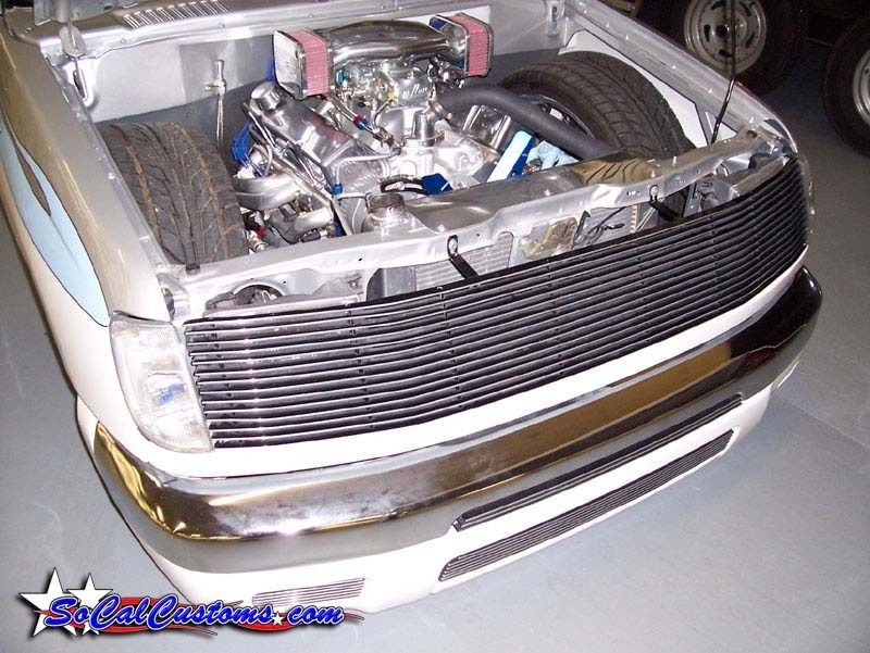

Originally posted by idragbodyS10
looks dope...
now im no god of custom fab or minitruckin....as some of you know LOLOL but....is that bumper meant to be like that? is this completely finished or is there minor details to take care of? that bumper needs to fit the front end better.
