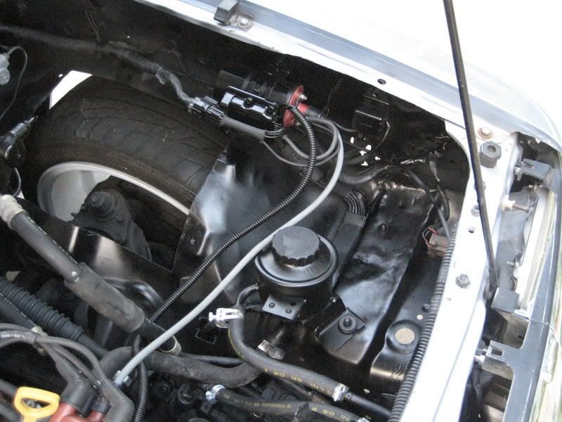

just bought some 4wd fenders off of ebay... i want to run nothing for inner fenders. Where do i put it all. The coil? air box? hood release? fuse box? thanks in advance.

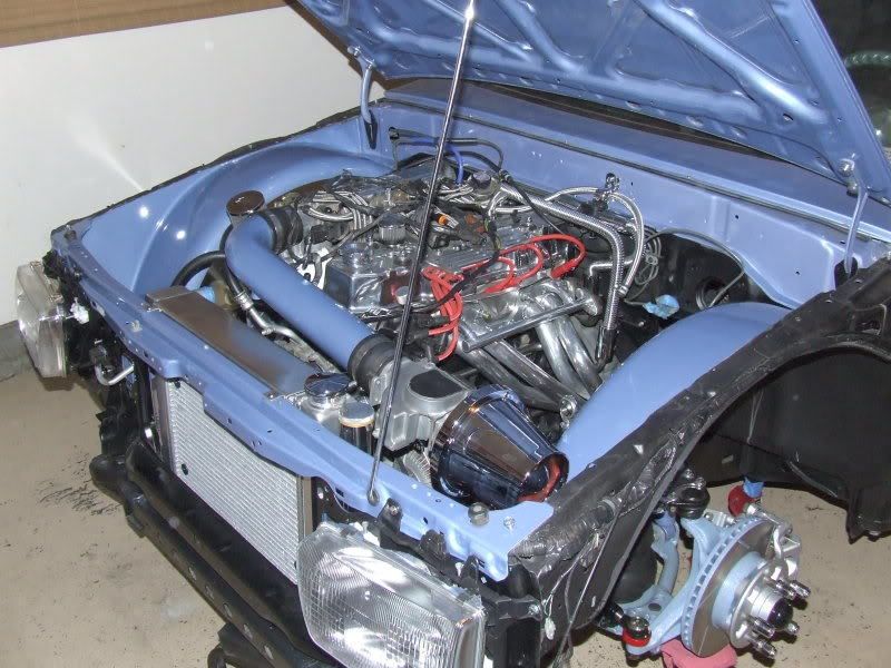

Here is what I did...

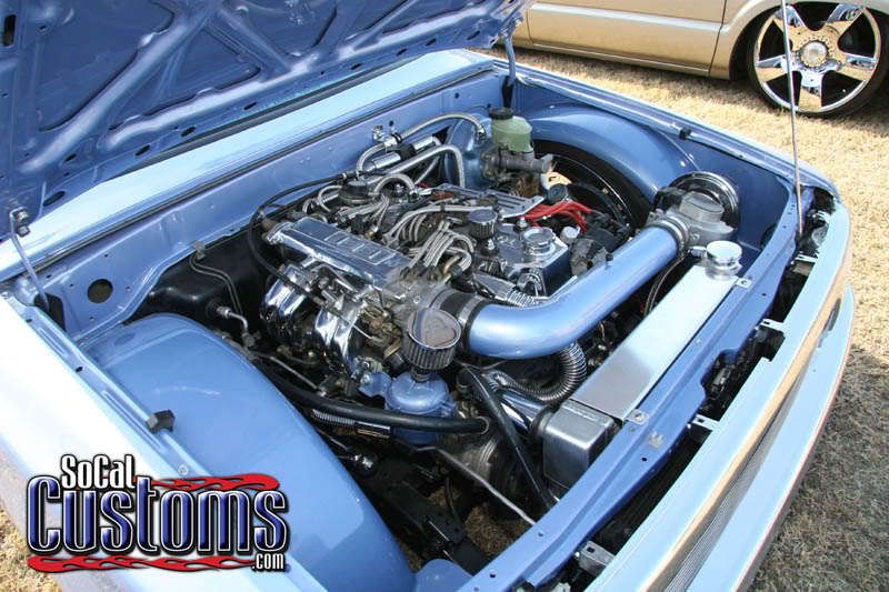

Here's some raised stocks we did.

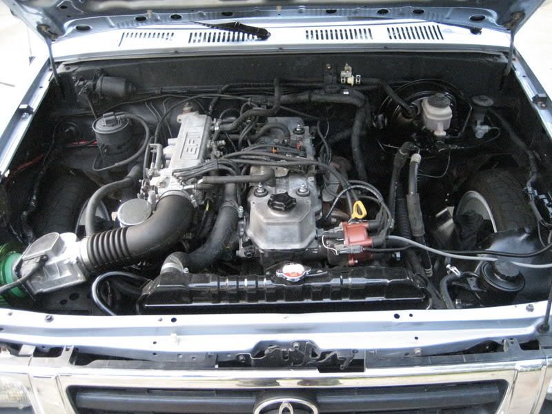

I have mine in the same places as SMCs.

Hide everything!
zip tyd's avatar
zip tyd
That looks sweet!
stll2hi
where did you hide everything...more pics?

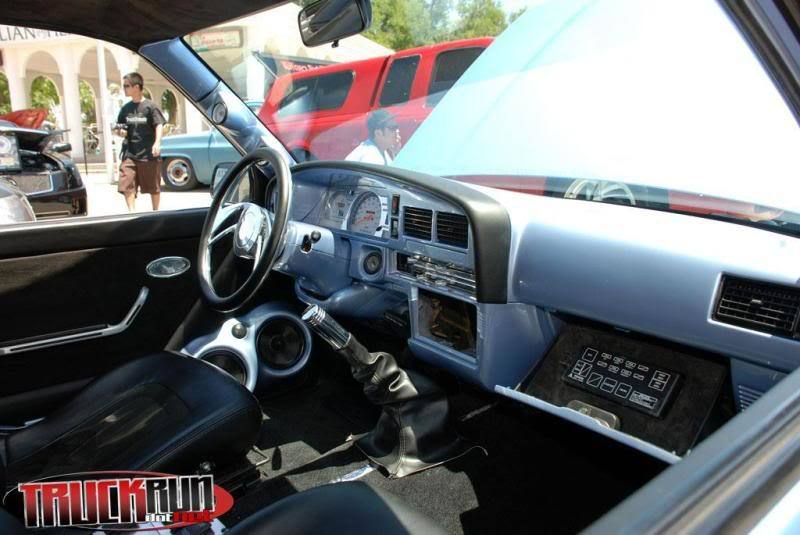

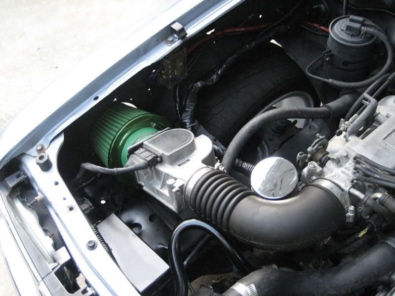

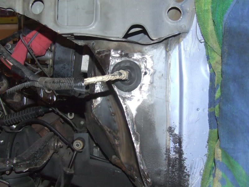

On mine I moved the coil to the core support, put on a K&N fiiter, and my all my electrical I ran between the intake manifold and engine and went through the bottom of the fire wall then put the fuse block under my dash behind the glove box. Doing that really cleaned up the engine.
stll2hi
thanks man i think thats what ill do. how did you get th efuse block in there?
draginrunner's avatar
draginrunner
I cut all the wires that were going through the sides of the firewall and rewired everything so I could have my fuse block inside, it was a long process but it cleaned it up quite a bit
