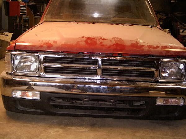

Well i have been messing with this bumper for 4 hours now and it seems it will never fit right.... I think I'm missing some peices because the only thing I have holding the bumper on is the 84-89 to 91-95 bumper conversion brackets holding the bumper on my 1986 pickup and nothing else. I got the truck when it was COMPLETELY torn apart so I dont know if I'm missing something. ALSO the bumper has about a 1/2" gap right in the middle between the bumper and grill, almost as if it's not back far enough, but the brackets wont allow it to go any farther back... did anyone have to modify their brackets or anything and if so how. Also am I missing a support or something because the brackets alone seems weak....

where did the brackets come from? The side brackets for the 86 will have to be modied to accomidate the new bumper, OR, just ghetto it with some tie wire ( your choice ) FYI, Conversion bumpers are NOT known for strength, they are for looks, but can be modified to be strong. FYI the aftermarket valnce was the beaotch for me, good thing its getting swapped out . . .
