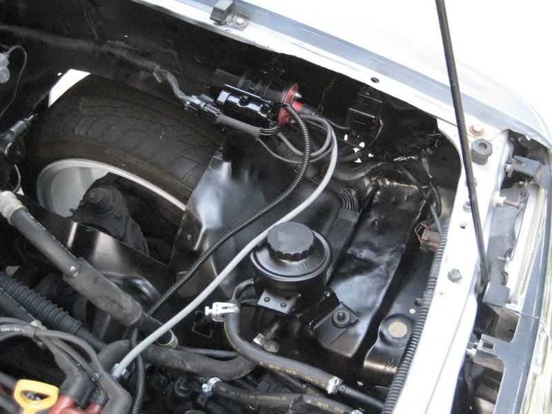

This is what I did to my 91...I just cut out enough so the tire would clear when turning & when/if I hit bumps in the road. Im running 17's with a 205/40-17 tire.

smctoy, thanks for the visual. i should be able to do the same.
