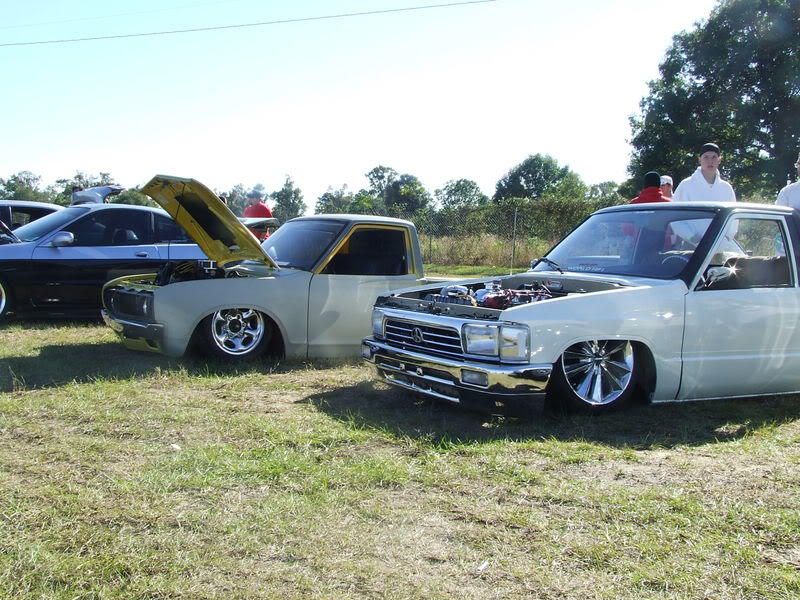

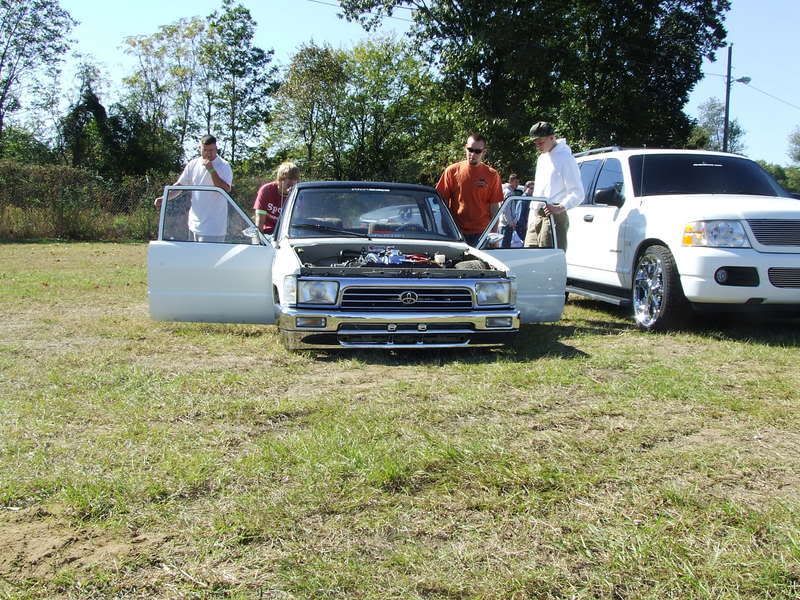

oldskl did it on his i wish he did a write up

lol i should drop off my truck and let him do mine
