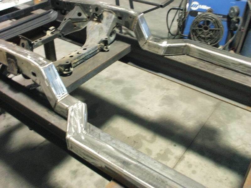

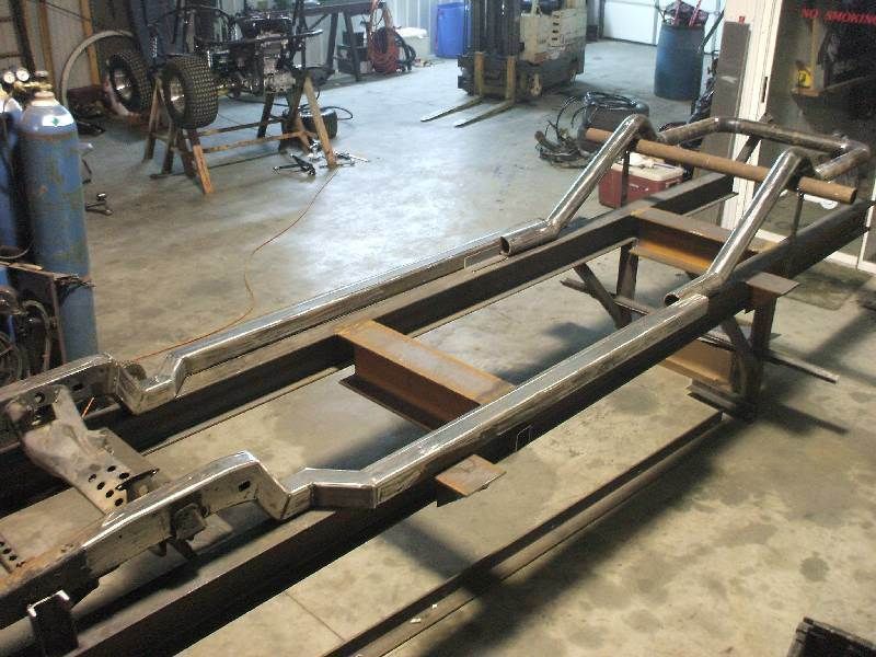

anyone have any pics of how they done theirs? I've been pondering on what to do with my truck when i park it in a couple months. Was contemplating a traditional BD, but i kinda wanna do chop top also so head room would be a great thing to gain. Thanks

thats a nice build. Congrats on one hell of a frame. But i guess i should ask does anyone have pics of joining the factory front frame to a new frame. Thanks

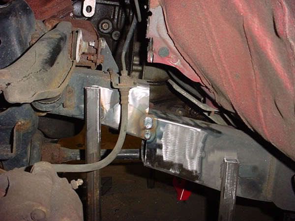

Heres some pics of how a buddy of mine Z'd his frame...

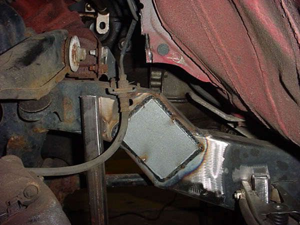

And heres how i attatched the frame to a stock front clip on a tacoma, this will work with any frame build...
loweredtoy
those are great pics. I just hope i can get mine to look somewhat near that nice
